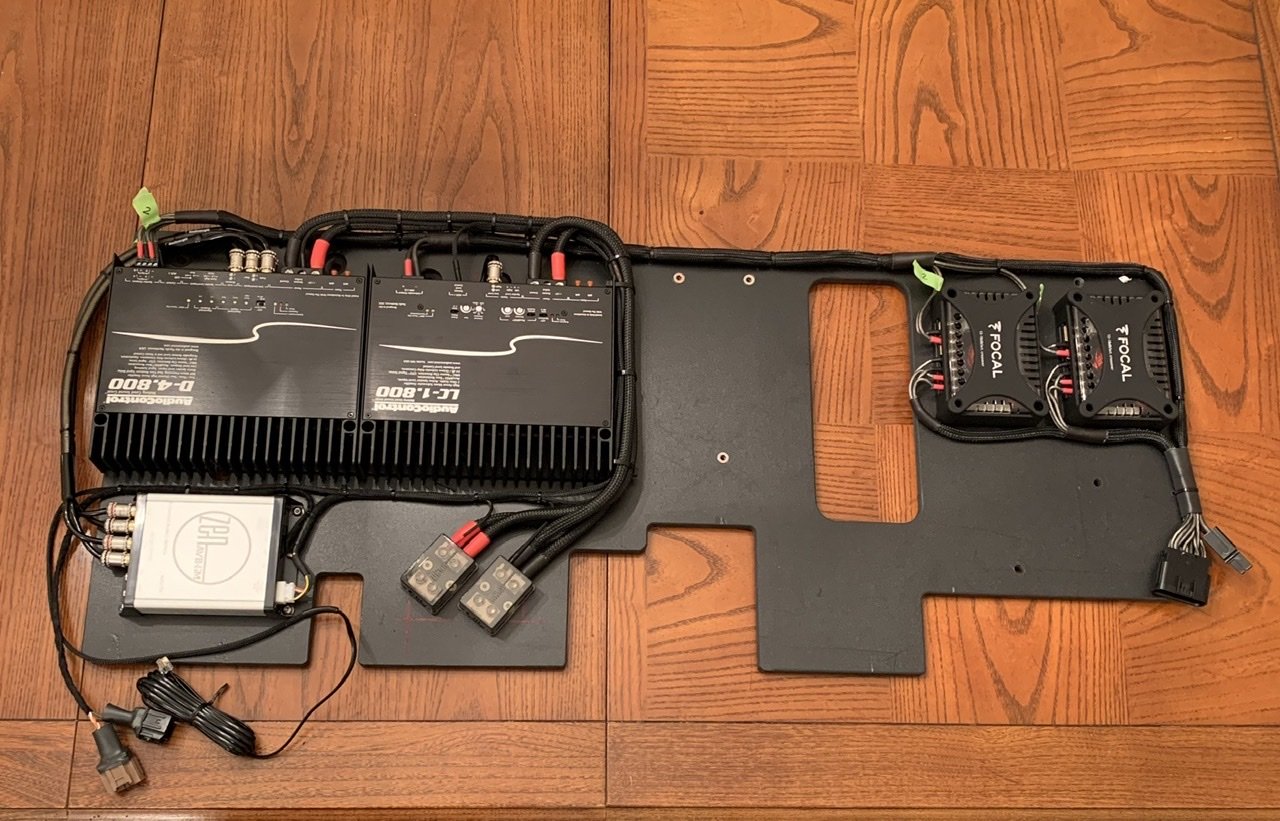

Yeah, that's exactly how I feel about it too. Do you have any pictures of your setup?
The blank spot to the right of the amps is where I relocated the rear seat heaters. The Bose amp is gone since I will be using the NAV-TV and everything else stayed in the original location.
