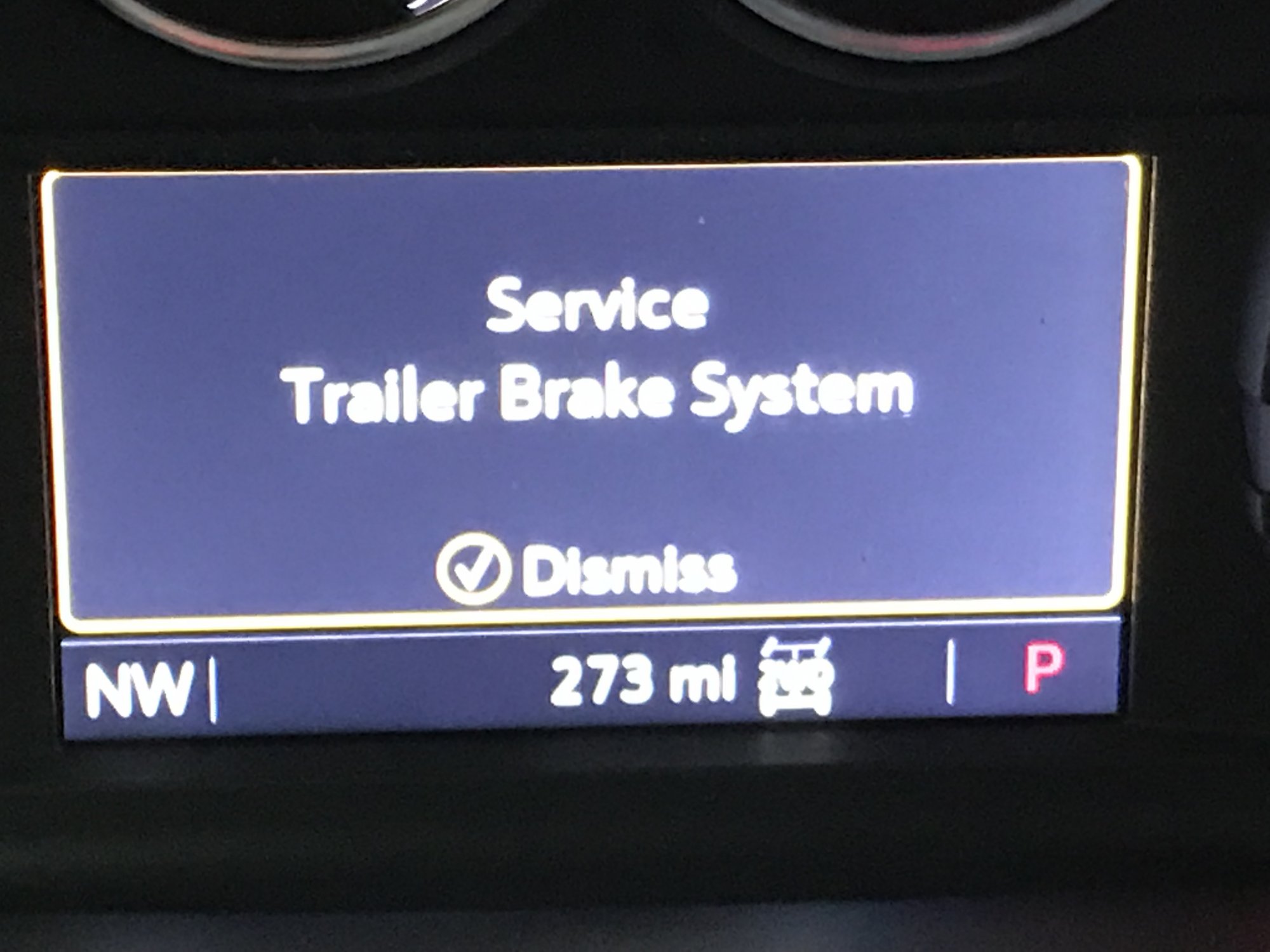

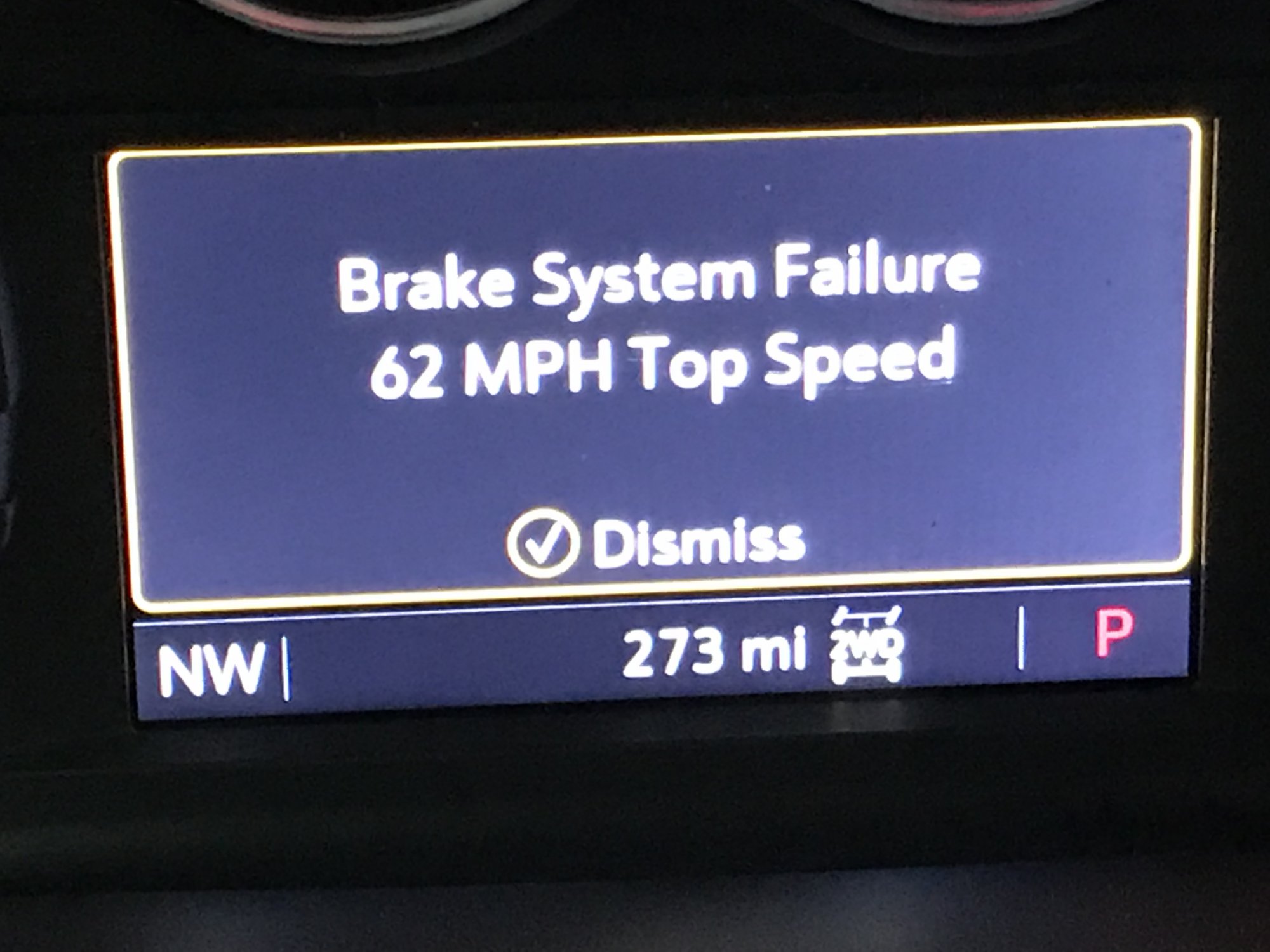

Brand new 2019 Silverado 1500 RST, 274 miles bought out of State and drove home and no brakes the following morning. The following Warning were showing up brake system failure, service ESC, service trailer brake system, service brake assist and check engine light was on. Does anyone have suggestions if you have to keep the vehicle or what is going on?
Ok, same old question, how did you drive your truck home with “No Brakes”?
I didn’t drive home with no brakes if you read the following morning was no brakes and all the lights were on. I asked for and answered not a smart response. Please move on if you’re no help.
