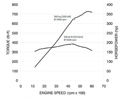

We don't know the whole story yet, but some of my observations so far:  Looks like GM simply when with an enlarged Gen. V version of the current L96.  Other than increased displacement, the only new features appear to be a forged crankshaft and direct injection.  The horsepower and torque figures are impressive and should be more than adequate even in a medium duty truck.  The engine has nothing in it that has not been in other LS engines for years, and should be completely reliable and as durable, if not more so, than the L96.  The Ford 7.3 is a completely new engine platform unrelated to any existing Ford engine.  Ford had to take this approach supposedly because the 6.2L was unsuited for medium duty truck use.  The 7.3 is not technically advanced and is strikingly similar in some regards to the LS.  It's bore spacing is a little larger than the LS.  Since Ford was not constrained using an existing engine's tooling, they probably figured what displacement they wanted and sized the block accordingly.  Ford has not released H.P. and torque figures yet.  I expect the 7.3 to have a little more H.P. and torque than the 6.6, but I think the 6.6's direct injection will largely make up for its smaller displacement.  I also think the 6.6 will be more fuel efficient.  And, I think GM spent a lot less money to develop their new engine.
I would not doubt 550 lb ft from the Ford... besting GMs setup by 100 lb ft should be no issue with 445 cubic inches.  Direct injection will not make up power.. The current 6.2 Ford is only a 34 lb ft deficit to the gm 6.6 so this 7.3 should be somewhere well above 500 lb ft.. possibly approaching 600 lb ft peak.
Gm spent nothing to develop their engine.  They took a current gen V, cast the block in iron and did not add afm or dfm.Its nothing more than a stroked 6.2... same old 4.065" bore size with a 3.858" stroke crank.   I'm more excited to pull these 6.6s from these trucks and do performance oriented things with them in other vehicles.  That or even use the rods and crank in an LS block.

Direct Inj. is actually the way to go. About 5% more efficient and tremendous torque on the low end. I would NOT be scared of this engine. I have an LT1 in a 17' Camaro SS and the new 6.6 has more low end torque.

The new 6.6L is not an LS engine. It is built on LT architecture. As far as DI far out performing port injection, not so much. The LS was port injected, we will use the 6.2L LS3 compared to the new LT1 for example. Same bore, same stroke, same overall displacement, essentially, GM changed upped the compression ratio and changed the fuel delivery method. With all that they only gained 20hp and 10lb-ft. If you took away the increase in compression, you would be talking 5hp, 2lb-ft gains from port injection to direct injection. Now, about the truck. Yes the new low end power increase would make the 2500 gasser and awesome unit and it wouldn't feel like such a dog. However, GM decided to change the final drive ratio from a 4.10 to a 3.73. This will likely take away and felt power increases available with the new gas mill. Pretty disappointing but it will lead to better interstate fuel economy, but what we were all after was to have a gas truck with some power, not take away the power increase through parasitic drivetrain loss.
