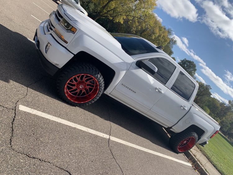

Hey guy so i have a little problem and would like some feed backs if anyone has ran into this probleM.  So i have a 2018 1500 Silverado with a pro Lyft leveling kit and i just bought new tires and wheels for it. 22x12 offset 44 I believe with 33inch Arturo trialing blade mt tires. Well i was reading a lot of review on this set up and there was at least 100 of these sets ups i found reviews on and all most all of them said slight rubbing and minor plastic trimming involved. WELL... i got my new wheels and they rubb like crazy on sharp turns. My truck drives fine UNTIL you have to make a sharp turn or back up a trailer. Now i was wondering if anyone has had to modify anything other then the plastic which i have already removed my plastic corner protector piece already and it still rubs on my inside fender. Just upsets me when I read all the reviews and they say minor rubbing well that isn’t true at all..

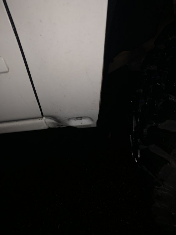

Thanks just made me upset when all the review said slight rubbing.it sounds like a thunderstorm when turning.. just don’t want to mess my fender up.. at least an inch of my tire tread rubs on bottom of fender. You can see where i removed that plastic piece and in the other photo online all of them still have there’s on..

I removed the plastic bottom piece but it’s hits my fender pretty good on turns I just don’t want it to mess my fender up!

You will need to do the NorCal mod to get those to quit rubbing.  Get your sawzall/reciprocating saw and get to work ?
beautiful wheels by the way, I was looking at those too!
