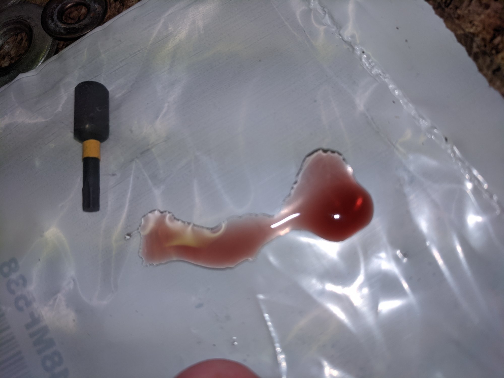

Ok so I got my transmission fluid flushed and filter changed.  Used the correct stuff (Mobil HD LV blue label), they told me theyd only use 20qts but they used all 24 qts which I feel is bullshit.  They changed the filter (which I will attach pics in following post).
Cost me 597$ out the door when I provided the trans fluid for them to use, that includes a 10% discount, includes tax.
Got sample analyzed for 28$,  took about a week but wasn't 100% paying attn so email might have come sooner.  It was slightly darker and didn't smell terrible, so I assume it was still ok. Attached is picture of fluid and my fluid analysis report.  They said aluminum was slightly higher, they guessed since this was most likely original fluid that it was due to during break in of transmission's built in pump.  But the maint schedule said it should have been changed at 45000 miles....so I'll have to keep an eye on it.Other than that there was nothing outrageous seen. Also NO WATER CONTENT which is what I believe caused many of the issues these trans saw so that's GREAT!
