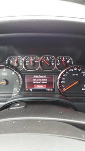

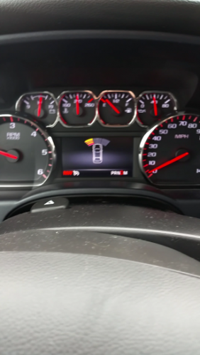

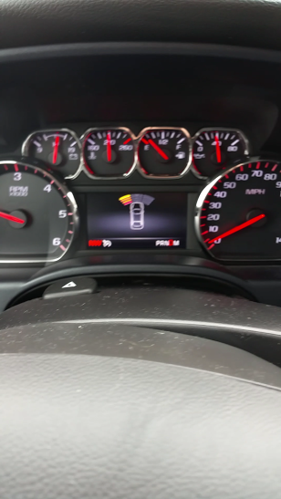

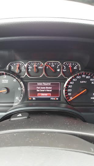

Just got my truck back from the dealer as they stated they could not duplicate anything I listed.
When I dropped it off I listed the following issues: park assist malfunctioning in snow, clunk in rear while breaking, hard transmission shift while decelerating, high pitched noise in 4 wheel drive.
I got in the truck and didn't even get off the lot before the high pitched noise was present. I shrugged and decided to deal with it. We are getting snow here in Denver today and as I got off the highway on the drive home a high pitched noise and my park assist lit up again for no reason.
2 of the 4 issues i dropped it off for are still present in the truck and I'd be willing to bet the others are too. I'm sick of driving a loaner that has a crappier interior than my truck so I didn't return it yet. I don't know what to do here...I guess I'll have to bring it back tomorrow.
