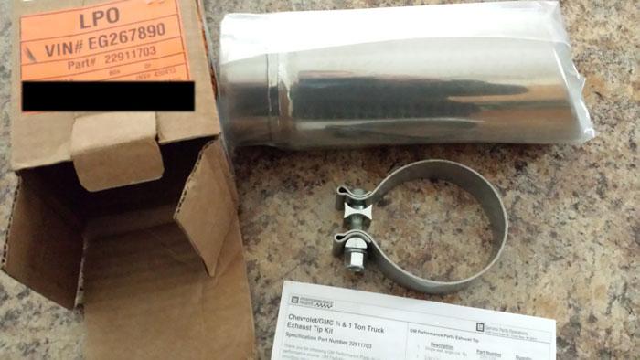

Every 2014 Denali comes with : VQZ: LPO - Polished Exhaust TIp which I didn't even realize I was missing until another member contacted me about this issue.
I contacted my dealership and said hey I am missing my VQZ: LPO - Polished Exhaust TIp. They said, oh yeah GM sent is a couple for the Denali's as they were not ready when they were built (which is silly).
So I figured, no big deal and I just picked it up and planned on putting on when I got home. The part/box even had my VIN number on it and part number was 22911703.
WELL, apparently GM forgot they put a 3" outlet on the 6.2L engines instead of the 3.5" which is on all the 2014 5.3L (EDIT - sounds like previous 2010-2013 Denali's had the 3.5" exhaust) and the 2014 5.3L are still 3 or less in circumference.
The other member said the dealer told him the VQZ: LPO - Polished Exhaust TIp are on backorder for the Denali's and GM sent wrong ones.
i am still waiting for a response from my dealer and currently have nice $90 exhaust tip for all the silverado/sierras with 5.3L but I assume I will have to return it :).

If I may clean up your information slightly.
The 6.2 was (2010-2013) produced with 3.5" exhaust. The tip that was being sent was for those year trucks not the new ones, but they were shipping with them for whatever reason.
The new 6.2 has 3" exhaust, in which the new tip part # 23435023 will fit it. These are being limited on availability for retail and will only be sent out for existing trucks that have the tip as an LPO option.
The 5.3 does not have 3.5" exhaust. Its either 2.75" or 3", but I haven't measured one yet...

thanks @newdude, I updated my OP to prevent giving incorrect info. Would be nice to know the Engineering reasons why they decreased the exhaust by about 15% from the previous years.
Exhaust velocity is more important than volume because they need it to flow through all the extra stuff on the exhaust now would be my assumption.

This is why I posted this issue as I went through the exact same thing, it wasn't until @beanland PM'd me about his Denali and chrome tip mishap that led me to contact the dealer about the $90 chrome tip missing.
