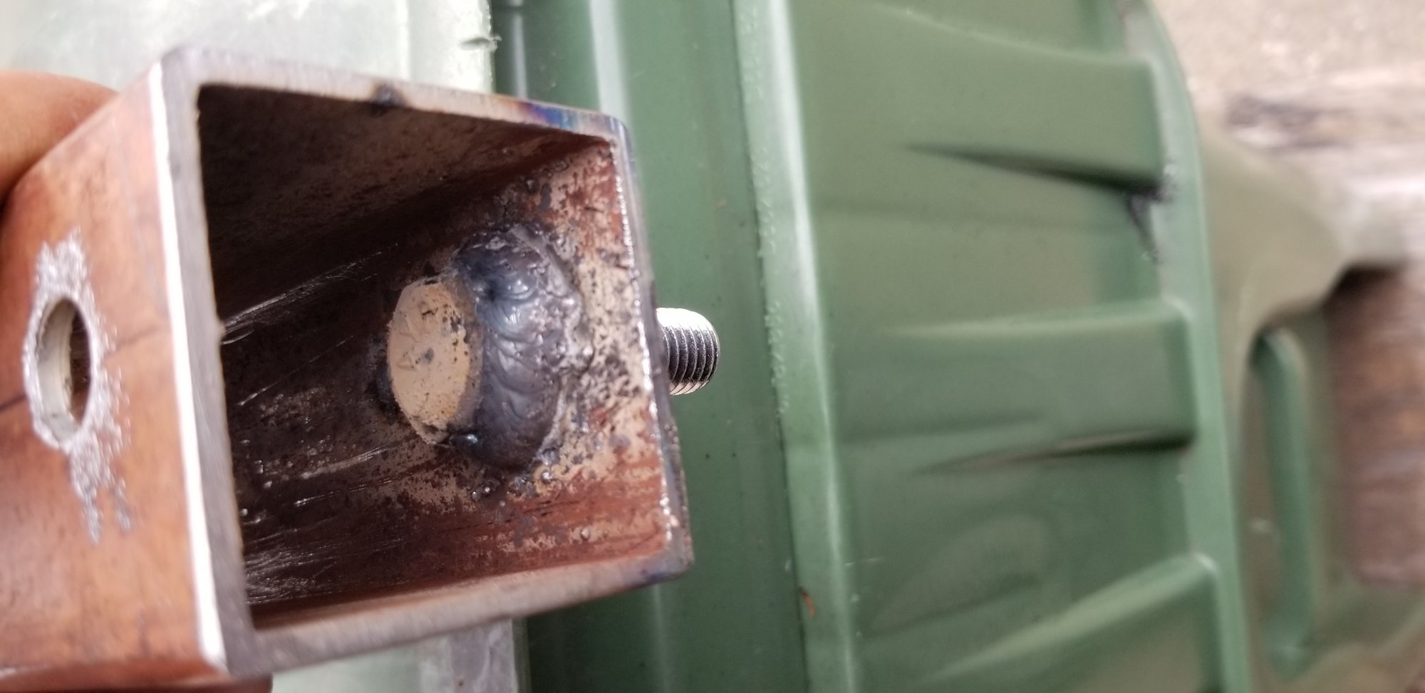

Built a 2" rear seat lift today. 2" square tubing 1/8" wall. 20-1/2"x1.5" bolts with lock washers and nuts. I welded the bolt so it acts just like the factory studs. Did have to cut about 1/2" off the factory seat studs so I could get my ratcheting wrench over the factory studs. If you lift the seat all the way up, you can fold the backrest down too.
My purpose for this was to gain room for 2 big 8" subs, and I'll have some storage on the drivers side as well.
