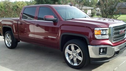

I'm pretty stuck here on deciding a direction for the look of my truck. Anybody have any tips on this? I always see lifted trucks on the road with big-offroad tires. I really like this look. BUT, I also like the look of a truck with nice big rims 20-22". Normally I don't see the bigger rims with huge/thick offroad tires on them. Does anybody have any advice for me here? Which direction did you go? Or can I get a big rim, AND a big offroad tire? Not sure how that'd look.. ??

You can certainly do both with good results. A lot of folks are going with 22" wheels and aggressive tires in the 33" range. And even larger wheel diameters with larger tires and lifts. I used to own a k5 blazer that I beat up pretty good off road, but I don't know too many people that buy 40-50k trucks to do that with, so the hardcore off-roading stuff is mostly irrelevant. The tires will more than stand up to the average off road situation. After all, I haven't seen any low profile off-road tires so comparing 20" and even 22" wheel combos as such isn't accurate.
Take a look at the basic sizes GM offers.
Your stock size of 265/70/17 has a sidewall height of just over 7"
GM size with 18" wheels is 265/65/18 and has a sidewall height just under 7"
GM size with 20" wheels is 275/55/20 and has a sidewall height of just under 6"
GM size with 22" wheels is 285/45/22 and has a sidewall height of just over 5"
So between 5" of difference in wheel diameters you only see a little more that 2" in sidewall reduction. I can tell you first hand that the ride on these vehicles with the factory 22s is very smooth. GM wouldn't have been putting them on their top of the line vehicles for the last few years if they didn't.
Now consider adding larger tires to these wheels. Let's use 20s since they are the most common size used and consequently, hated on...that will shift to 22s now that they are becoming more standard but I digress.
Let's use 305/55/20 which is a common size for mildly lifted or leveled GM trucks. This is more or less the equivalent of a 33 x 12.50. I'll compare it to the stock 18" size offered by GM as it is the more popular size when these debates come up.
The 305/55/20 has a sidewall height of just over 6.5" which is just shy of or the same as the stock 265/65/18 depending on the tire manufacturer. Not bad for "low profile tires." Go up to a 35" tire or 325/60/20 and you'll have closer to 8" of sidewall, which you'll note is more sidewall than any of the factory sizes listed above.
Once you get into lifted territory your ride will suffer for a great many reasons but the impact isn't great. And I assure you that my wife's 2015 tahoe on 22s rides far better than my truck with 37s and 20s. I mention that because ride has a great many more things do with than sidewall height alone. I've had big tires and small tires and wheels from 15" to 22". The ride has never been greatly impacted by the wheels diameter and the off-road performance hasn't suffered either.
Don't be fearful of getting what you thinks looks good and don't worry about your truck riding or performing badly as a result. Good luck.. :thumbs:

I love 22's. I have factory chrome GM CK919 wheels with Bridgestone tires. Ride great. No shakes or vibration. I put 22's on my last 3 GM trucks.

22's absolutely fill the wheel well nicely. GM factory 22's on the K2 platform is badazz. Big wheels with an aggressive tire is an awesome combination.
