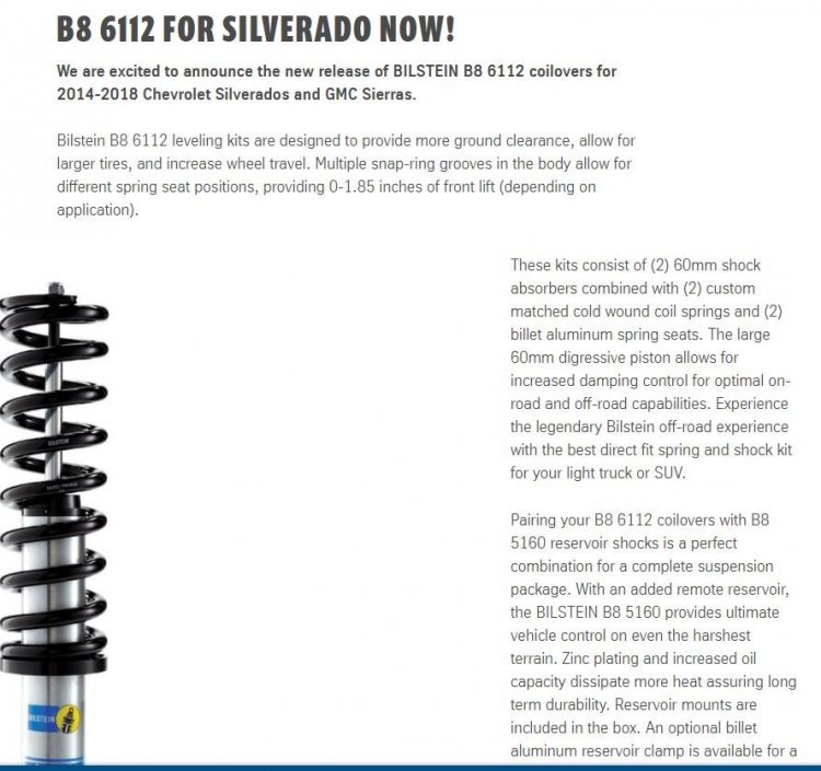

Where are you getting these pics?  I see they're on Bilstein.com now but I can't find what you posted.  Do they list the spring rates? When I called Bilstein last they didn't have that info.

On 3/19/2019 at 8:01 AM, bhales said:
Can you share actual links? I was just searching yesterday and found nothing.
Downsouth Motorsports has these. The cost though for a non coilover seems a bit pricey.
I asked about them a while ago. They aren’t super popular around here because of the cost
The 6112 was avail in 2016ish I believe.
