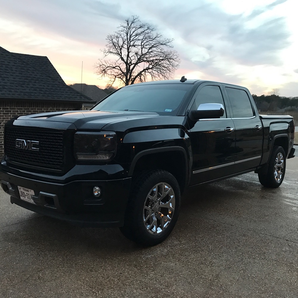

Had mine powdercoated a few months back. Paid $200 for the front and rear bumpers plus $100 for my buddy at the shop to take them off. I helped with removal but didn't do enough to give you instructions. It wasn't horrible but it wasn't fun either. Well worth it though! Looks so much better and definitely changes the whole dynamic! Go for it man!
That looks great!! Thanks for sharing it.
Yes! Thanks for sharing! Sent you a PM.
