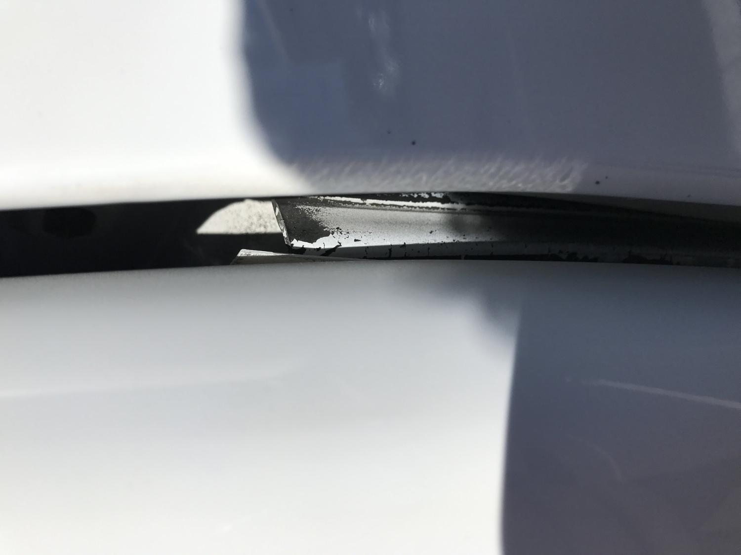

Long story short, I got a spray in bedliner today and the installer told me it had been in an accident. There is overspray between the bed and the cab, and the paint is rougher in that gap. I honestly dont know whether to be pissed or not, cause I would think the dealership would know. I tried to get some good pictures that showed the overspray, what would you guys think or do?

It could be nothing more than dealer overspray from dealer giving some wheel well and or inner fender touch up paint
Idk.. there is primer there too. Looks to be more than touch up, sadly.

That looks like the whole bed/cab side was painted. If you look at your reflection slowly walking front to back there will be a noticeable difference in lack of clarity on what was repainted.

How do you know it's the whole bed?
The amount of paint overspray suggests a large area was being painted unless it was a very sloppy touch up.

It seems that the moulding is painted more than 8 inches across to me. Tough to discern from the picture.
