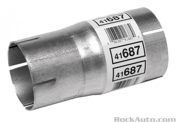

What you need is a reducer.
http://www.rockauto.com/en/moreinfo.php?pk=133566&jsn=33&jsn=33
Check your local automotive store, or order two online. Just make sure you find the right I.D. vs O.D. dimensions. Or find a muffler with the same size pipe as your truck and skip another joint.

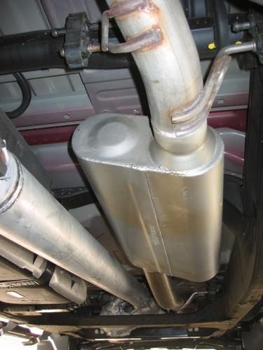

Muffler shop will have it done quick and right in no time - took them 20 mins to do mine........ Linked in my sig.........

A good muffler shop can adapt - note the Flowmaster 53553 with offset exit fit fine in pics above.
I was going to leave the flapper to avoid the v4 chopper sound
So was I - glad they removed it at least with this muffler - no chopper sound. A lot less restrictive muffler might be a different story for V4 noises. And I would call the Borla 40359 a less restrictive - less noise controlling - smaller size muffler. So probably good to keep the flapper....
You are right Krusty a good muffler shop will be able to make it work regardless but a less competent one will do a hack job or persuade you into buying something else when things get more involved.
