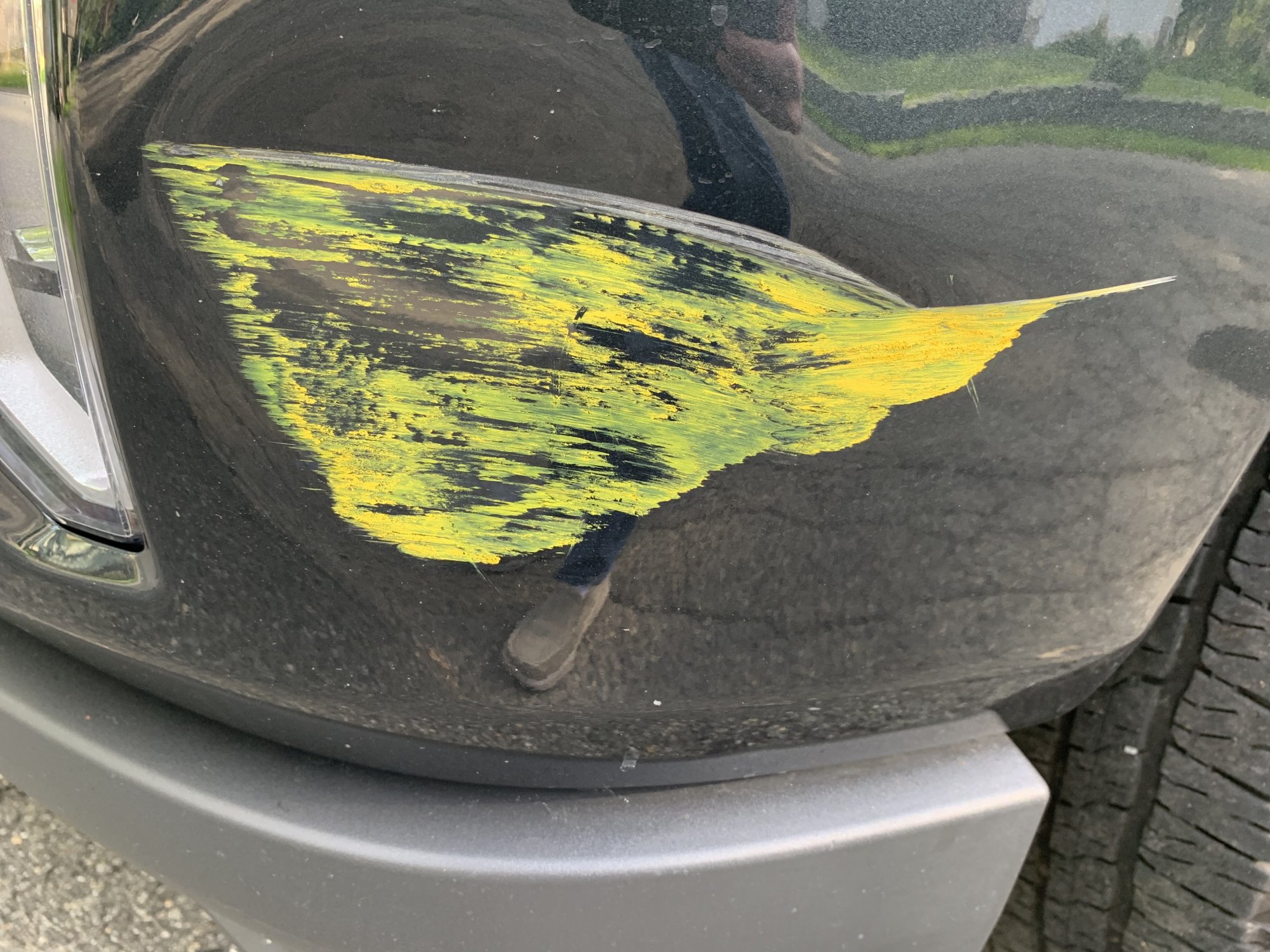

UPDATE:
So they replaced the vacuum pump and the dealer is in talks with GM to have the bumper damage repaired. The yellow paint really stands out on the dark paint. 9B6128D0-E2BA-4A37-8155-FA6516D2C234.thumb.jpeg.2d2de39f52c7afab22e121333841fed4.jpeg
