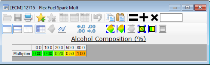

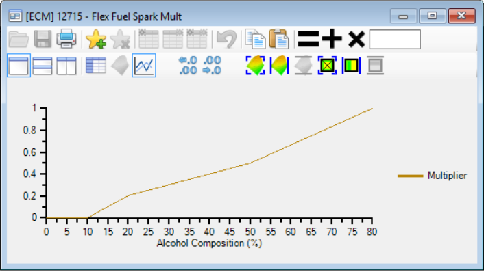

On 12/5/2018 at 8:27 PM, TJay74 said:
You only need E50 to see about 80% of the HP gain from running Ethanol. The timing modifier tables in the ECM are E-40/60/80. You dont even see the maxing timing adder until you are over E80.
Here is what the tables in the HP Tuners looks like for the E92A PCM for a 2018 Silverado LV3. The table allows modifications to be made at E-10/E-20/E-50/E-80. I believe adjustments to the spark multiplier are blended in a linear fashion between the points in the table. Meaning you should see similar gains @ E49 as you would @ E51.
E50 is excellent power/mpg/value blend for any Flex Fuel vehicle.
Good discussion.

From what I'm seeing in the tune, any flex fuel ecotec3 could benefit by running a minimum of 20% ethanol blend. If the GM engineers thought it was enough to start advancing the Spark Table at that leve, it has to be worth it.
I don't drive my truck daily so I wouldn't be able to test my theory.  But I'm fairly certain that there would be very little to no noticable mpg loss but slightly more available power by running a 20-25% ethanol blend vs standard 87 octane E10.
I will most certainly will be adding 3 or 4 gallons of E85 to every tank from here on out.
