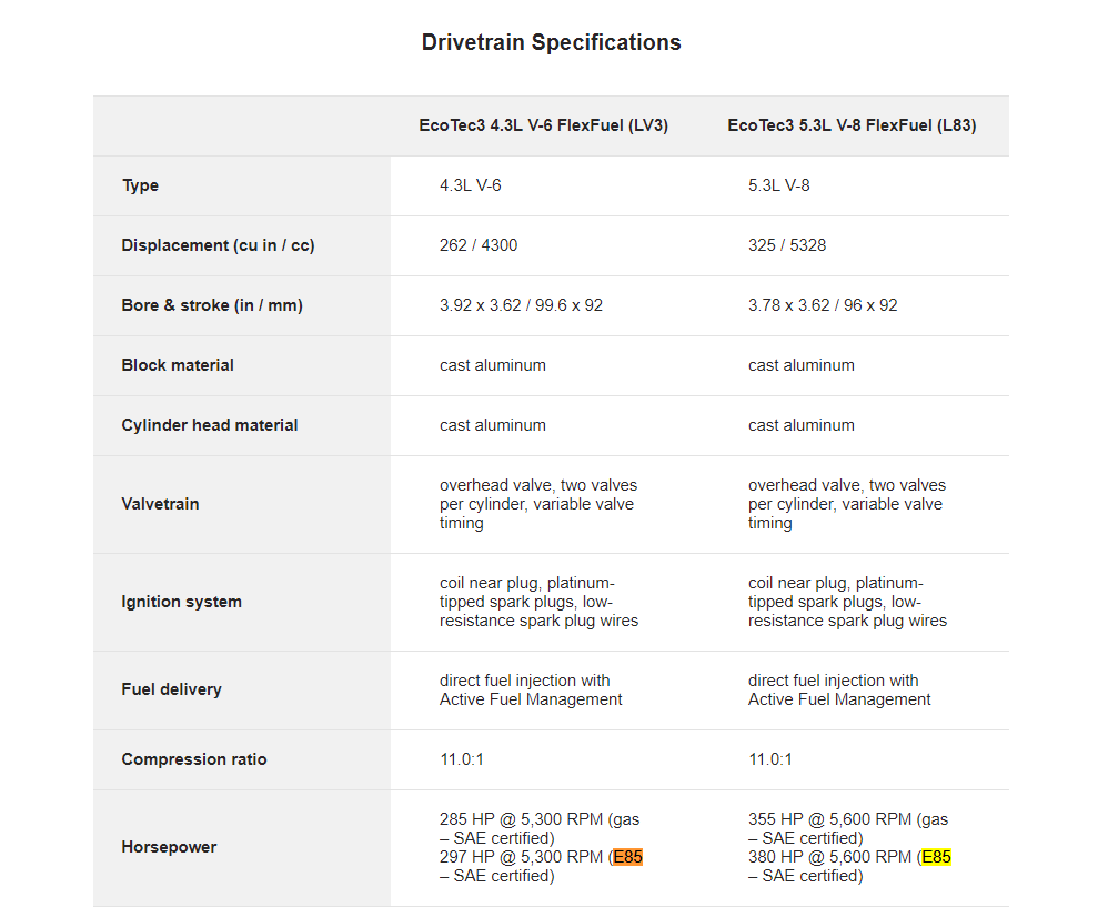

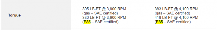

GM does not show any power or torque increase for the 4.3L running E85 like they do for the 5.3L.
I ran E85 in my 2017 2500HD 6.0L.  It has to be $ .60 per gallon cheaper to make it cost effective.  It wasn't .60 less than E10 very often.  However, my 6.0L seemed to idle smoother and start easier when using it so I just did most of the time.
  • Replies 65
Really? No power increase for 4.3? Then i guess its senseless to run it if it decreases my fuel mileage and gives nothing in return. RATS

Lots of misinformation in this thread.Unlike the 5.3 all of the 4.3 are E85 compatible as a standard regardless of gas cap color and it is a 15hp and 20tq gain at the wheels versus running straight gasoline.You will take roughly a 2.5mpg hit at the pump but it is cheaper per gallon and there is a marked difference in pickup.Next time you run the tank dry go ahead and give it a try
