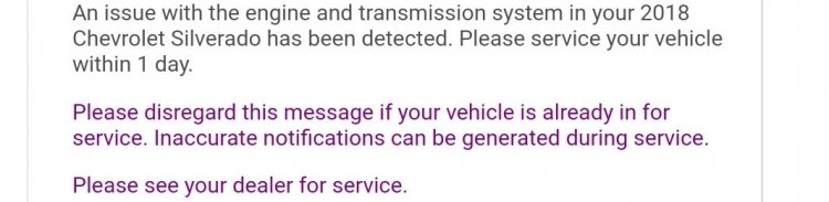

I attached 3 notifications I received when this happened.
