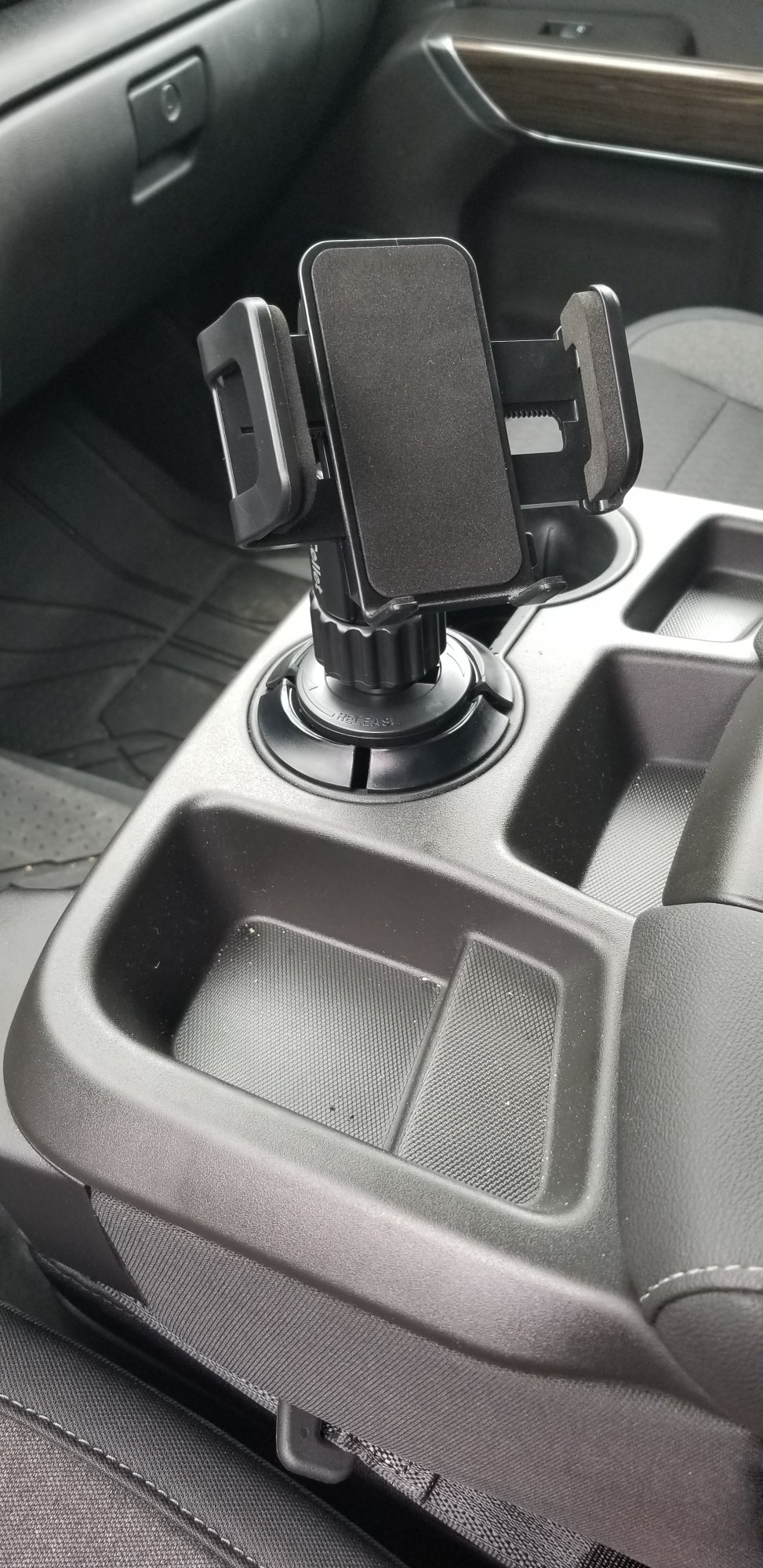

5 hours ago, Ozer said:
On my 16, I just rest my phone vertically between the 2 ridges in the console shown above. It's a reasonable spot for my needs and cost nothing extra.
I just can't get into the cupholder ones.  They look like they hold a phone real well, but I'm already down one cupholder from my 2017.  And I take a coffee and a water with me every morning - 2 cups.  The door cupholders are annoying to use.  Plus the phone is way down there, I need it on the dash so I'm not looking to far away from the road.  Maybe in a console setup it might work, but not bench seat.
Those are all valid points.
I just installed mine yesterday.
So, time will tell. Its very sturdy though.

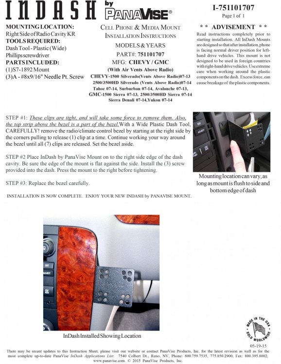

On 7/23/2019 at 4:15 PM, mbaee said:
Pictures attached as promised.  I like this position because it it within easy reach for Google Maps and Spotify and I can easily plug my phone into the radio for Android Auto or (my preference) a quick charger in the 12V socket.  I primarily use the Android Auto app on the phone screen so I can use the quick charger.
I used some left over computer fan screws I had laying around (link below), but any basic screw should work.  I drilled pilot holes so the screws wouldn't crack the plastic.  I also had to take the dash panel apart (same as installing the auto start/stop eliminator) because the filler panel wasn't fully locked into the clips on the back and it pushed in.  Once I made sure the clips were fully seated it was solid.
Fan screws: https://www.amazon.com/Computer-Cooling-Mount-Screws-Pack/dp/B01LLKY3GO?ref_=fsclp_pl_dp_1
How do you get that cover off? Which bezel do you need to pry? My truck is only a week old but was thinking I’d doing something similar.
My Jeep Wrangler that I bought back in 2012 has a PanaVise mount that screws to the dash behind the panel. I have just emailed the company asking if one I found on their site would work for my 2020 AT4 because on the site they say it works for the 2018 Sierra/Silverado's. I will post here when I get the answer. These metal mounts work amazing and will hold various cell phone mounts because of all the different mount holes. They're about $33.00....
Marc
Edited by dali555
Better Image
The outer bezel around the screen with the buttons and controls comes off.  Same process to install the auto stop/start eliminator, which I also have.  There's a thread on here somewhere.  Here's their Youtube install video if it helps.  If you don't have the full front console, it will be similar.
https://www.autostopeliminator.com/collections/autostop-eliminators-for-gm-vehicles/products/2019-silverado-sierra-autostop-eliminator
https://youtu.be/eQ5h3n-290o
