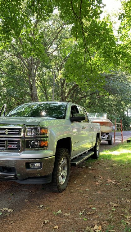

So I’ve been on the hunt for some quality tow mirrors for a while now and haven’t had any luck. Any of the ones I find on amazon either say they don’t fit my vehicle or the reviews are not so good and just nothing really promising that what I get will fit or work completely. I have a 2014 1500. If anyone else has upgraded to tow mirrors on their 1500 any links/recommendations/information would be appreciated. Couple pictures attachedD88BA3EE-6398-49FB-AF41-8D4283685555.thumb.jpeg.709414fd27a5c602d236f30ecb8d4fd7.jpeg

Pgamboa is definitely the person to pm for answers to all of your wiring and mirror related questions.  He is very approachable and truly knows his stuff!   When I look at your trailer and truck setup. I wonder if you've considered a' wireless camera setup?  Your boat is narrow when compared to most travel trailers allowing your stock mirrors to meet most of your needs.  The significant blind spot is behind your boat which can be fully visible with a wireless camera.  Check out Haloview wireless cameras or others on Amazon.  I went this route with my narrow (7') travel trailer and have a full 180 degree view directly behind my trailer.

Thanks I’ve read through his thread and gonna order through him since he makes the wiring harness I’ll need and everything. But yeah the mirrors I have now do just fine for towing my boat since it is relatively narrow, I’m primarily wanting to upgrade for looks
