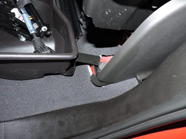

I reinstalled the cheaper aftermarket from my '16 which fit just fine except for interference with the new location of the jack. Problem solved, unbolted the jack and bolted onto the bottom of the plastic bin .....fit just fine and the anchor brackets secure to the seat bolts just like in the '16. You can store a few hundred pounds of crap in it and it will remain in place in a sudden stop. Plus the high lip seals the entire bucket without the jack cutout so it is waterproof and can store snow covered boots or hold a few gallons of spilled liquid.   Might even serve to catch water leaking from the infamous rear window and keep the carpet/jute backing dry in the interim.
DSCN0804.JPG.b6156f545ed249b1994db12398b10dcb.JPGDSCN0805.JPG.ae8f255de1fd89570e8ebf421150cd91.JPG
You need to pop holes into the storage and remove the jack holder and move it to the inside of the storage.
Do this. The underseat organizer in my truck does not budge, you can barely lift the front of it to slide part of the mat underneath.
