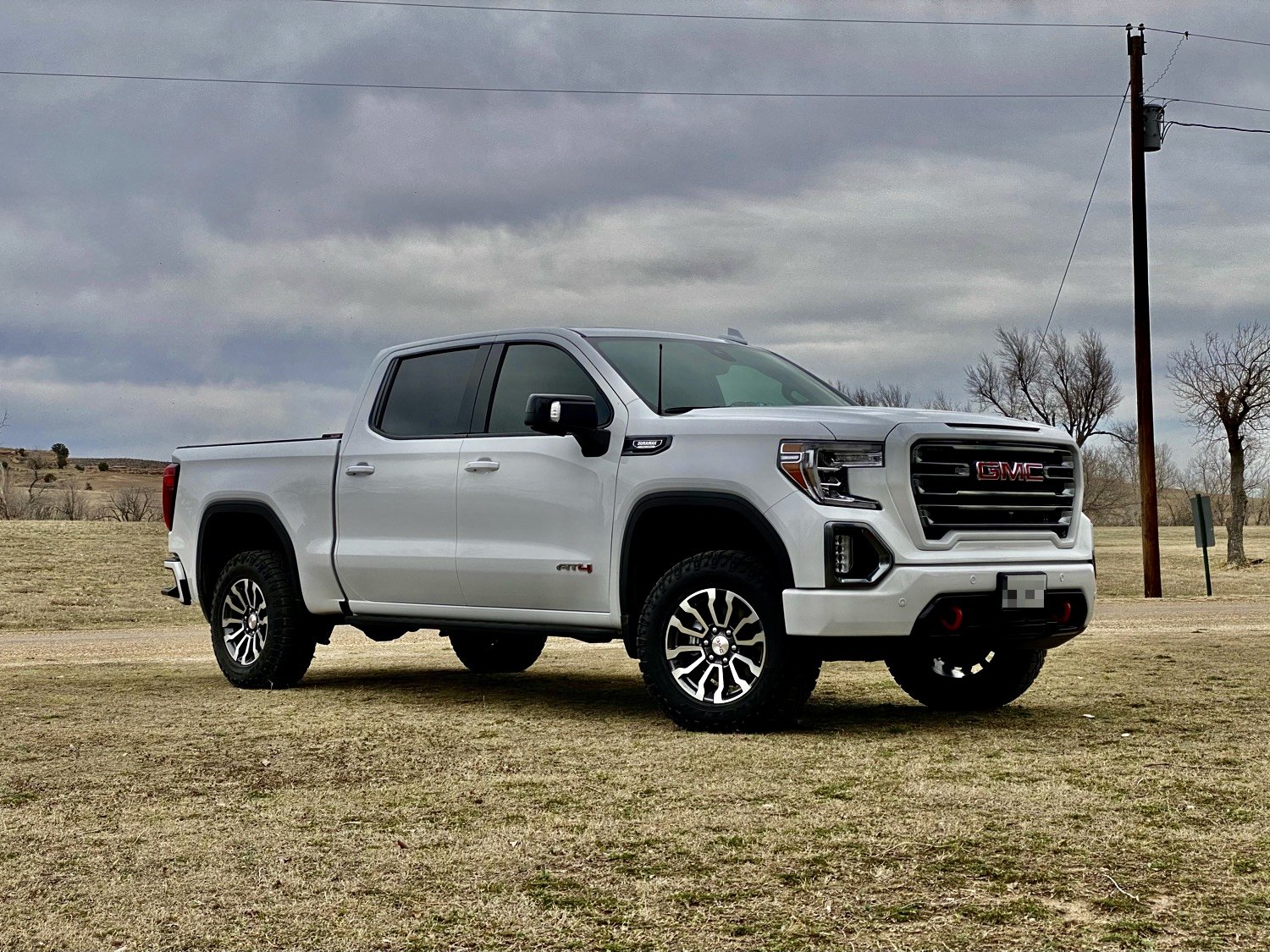

‘21 Sierra AT4 3.0L dmax
Bilstein 5100 front and rear, 1.1” setting
Cognito UCA, round
Stock 18” wheels
Stock Duratrac 275/65r18 tires
Still has some rake (I haven’t measured it though), I’d prefer it be more level but I don’t want to mess with any spacers so I guess it is what it is.
After these tires are done I want to try 285/70r18, I’m just concerned about the UCA and tire clearance. I like the stock wheels just fine so I don’t really want to change them.

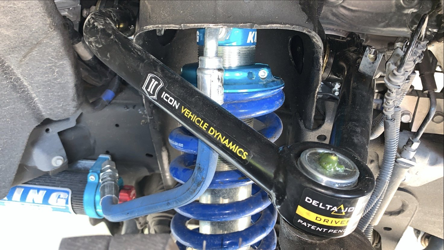

I’m rockin’ the ICON delta joints. Been great so far
How do you like the Kings? I was lookin at them from accutune with those same arms! Delta joints seem like best option for a street driven truck that will see weather etc.
Love em! I got my set from Filthy Motorsports w/ the Deaver Leaf Springs. The Delta Joints have been great as well. They’ll get the job done till I upgrade to a long travel setup. Accutune are awesome at what they do as well, you won’t be disappointed!
