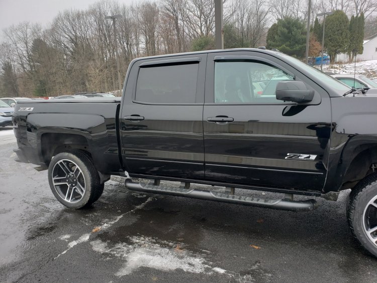

285/65r18 ko2's on factory 18s. 2.25" level. This was before i debadged and blacked everything out. No rubbing anywhere.2eb5d78d76704cdbaf1870f9d2162fcf.jpg

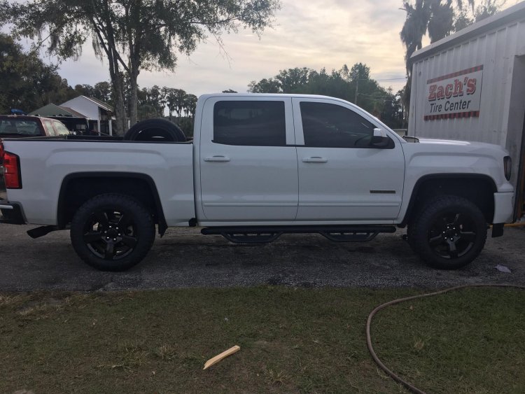

Just had the Nitto Ridge Grappler 275/60/20XL done on my 17 Sierra. Love the ride, just need to figure out the correct tire pressure. Any recommendations?

I’ve got the same tire 285/60/20’s, running them 38-40 psi

Thanks, I did the chalk test yesterday and 37psi seems to be the sweet spot on mine.

That looks VERY nice, love white with black wheels...
You’ll love the tires, very durable
