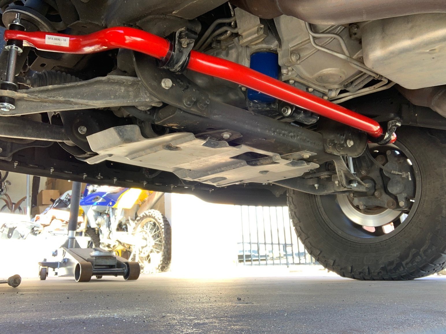

My truck now has front and back upgrade sway bars. Front is a 38mm solid steel bar with poly bushings and upgraded links.  Rear is an ADD ON 30mm rear bar as these trucks do not come with rear sway bars. No drilling, cutting or anything required. Simple bolt on. Looks like it in the photo, but it clears a full size 33" spare. Dramatically helped the truck is everyday driving. I dont feel like im going to fall out of my seat when taking a corner at 30mph, or even a simple u-turn.
My truck is lifted in the front with a 3" lift spindle and a RC under strut spacer  (soon to change once I get new shocks)
