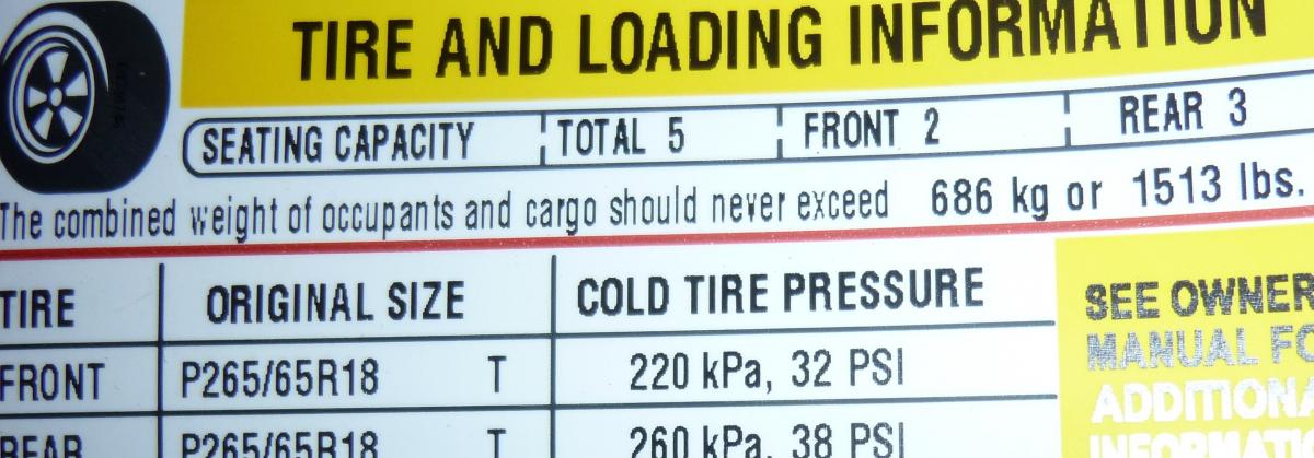

Disagree-If the OP tows a 11,000 pound trailer at a 12% tongue weight that comes to 1,320 pounds. His payload is 1513 pounds. Where is the room for cargo? He puts a 150 pound passenger and an ice chest and he's at the maximum. NOT WHERE YOU WANT TO BE-IMHO.
Half ton trucks (generally) cannot tow their maximum rating due to PAYLOAD limitations.

IF you had 1320 lbs tongue weight, and me, you'd be slightly over loaded...forget about a passenger or icechest!

I cannot spell "tire". I've attached the max load capacity from my truck door jam.
The rub is if you towed an 11,000 pound trailer your tongue weight would be 1332 pounds. Your remaining payload would be 181 pounds.

A half-ton truck cannot tow it's maximum rating without going over payload. After all, no body camps alone, or takes an ice chest, or a friend/wife, dog, kids, etc.? Right?

Your target tongue weight above is 232 lbs too high--there would be 413 lbs payload with a standard 11000 trailer setup. Are you implying the OP's wife is really, really, really fat?
Besides, the OP said he would be staying under 8000 lbs leaving 713 lbs of payload with 10% on the hitch. I would hate to meet the wife/dog combo that exceeds that! Telling somebody he needs a 3/4 ton to tow that much a few times a year is silliness.
