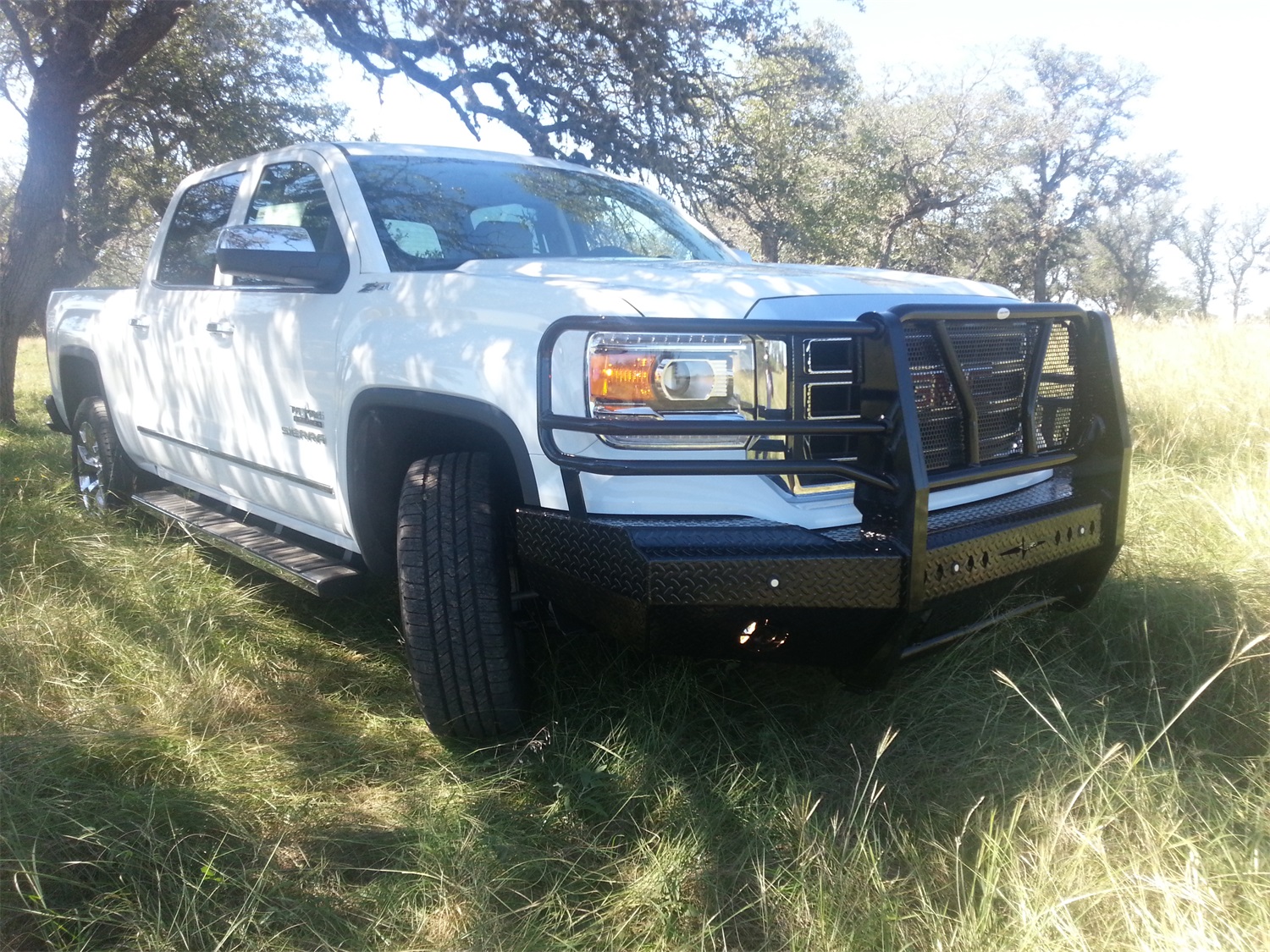

As for the goods. I've been scouring the web for ideas on bumper replacements with grille guards. I showed the wife what I was looking at getting and she just kinda shrugged, so that's a good thing LOL! In all seriousness, my current brush guard will provide deer protection enough to keep me relatively safe in a collision but it'll definitely need to be replaced after. The time I worry about wildlife is when I'm responding to a call. I'd hope the God awful amount of noise my dual sirens create would usher off any deer but that's not something I'm really willing to bet. Hitting a deer at 90-96 MPH while responding on Interstate 70 would be a devastating impact and I want to ensure I have as much insurance against those bastards as I can get. Hitting a deer on a 2 lane county highway while responding at 60-70 MPH is my real worry, that ditch comes up pretty dang quick at those speeds. My goals will be just to protect critical components so I can safely slow down and get off the road to a safe spot. I want to ensure my suspension is guarded slightly and I don't rupture the radiator blinding my view in that event.
I found a pretty good value bumper replacement that would fit the bill it seems, Frontier Gear. Runs $1,020 shipped which is pretty well priced.

The thing you have to watch out for on the bumpers is the tubing is pretty thin on a lot of them. A lot of people run ranch hands, but their lower center bar is pretty weak from what I've seen, vs the piece of thick rectangular tubing on mine. I have seen a few newer Thunderstrucks with a piece of horizontal plate metal in place of the lower bar, which I'd bet is just as strong if not stronger. I have yet to hit a deer with mine (without the bumper I would have probably hit 3 :lol: ), but on our work trucks they've been very effective.
The nice thing about ordering local is you have a lot of options (holes/surface/structure). They'll generally punch holes for lights, sirens, winches, etc wherever you want them. Not sure how this is done now (at least through Tstruck), but usually a dealer (like k4 trailer or similar) will set it up.
The Frontiers are good quality from what I've seen. Whatever you get, make sure it has a quality powdercoat.
Ah, good points. Kind of how I feel with mine, as many deer as I see I should've hit one by now *knock on wood but they seem to elude my truck, fine by me! It's just that one time at 80+ that freaks me out.
I'll have to checkout the local shops. I know we have a few pretty reputable shops, 4x4 LAND and Xpert Offroad that are well established - may see what they can come up with. Thanks for the points!
