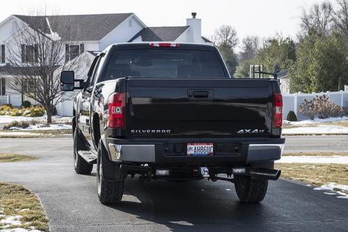

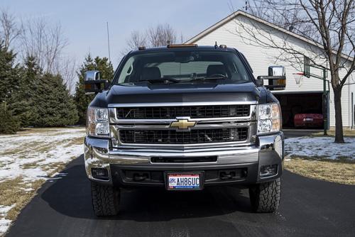

I just posted this in the 1500 section and thought it should also go here. The 2015 chrome tow mirrors are available on ebay for $180.00 a pair for 2007.5 through 2013 models. They are a direct replacement for the factory models and are excellent quality. The clear LED's on the back side of the mirror need to be connected to a wire that's hot when in reverse to light when the truck is in reverse and when you unlock the doors with the remote. There is a reverse wire connection in the MBEC inside the cab that's will work for this. The front amber lights work only as turn signals unless you modify the wiring to make them work as running lights when the headlights are on. This is a picture of my truck with the mirrors installed.
These mirrors are also the available for prior years if you google for your year.
