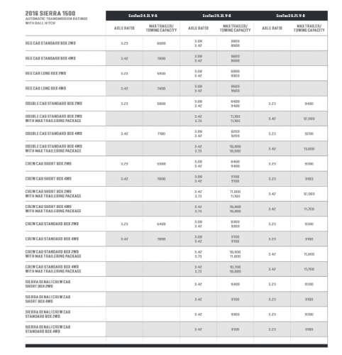

Are you sure about the rear end on the '16 5.3 8 speed max tow? I could swear both the '16 6.2 and 5.3 8 speed Max tow came with 3.42 rear end.
That's what they showed in the video. I don't have the link but just look up "The Fast Lane Truck" on YouTube. It's the newest video they posted. It pops up on the video at the 1:57 mark in the video that the truck has a 3.73 rear end.
Which unless the truck has the 6 speed in it the truck doesn't have. I take their tests with a grain of salt..... they are all over the place constantly and have misinformation in about the same frequency too. The truck did well either way though.... but unless they are running the 2 trucks side by side that same day I really don't care what they ran lol. I have varied by nearly half a second on naturally aspirated street rides depending on the density altitude on the given day. That's just drag racing in a quarter mile.... running up a mountain might vary by 30 seconds..... again.... grain of salt.
See where it has both ratios listed for 5.3 max tow? The 3.42 is for the trucks with 8 speeds, the 3.73 is for the 6 speed Max tows.
