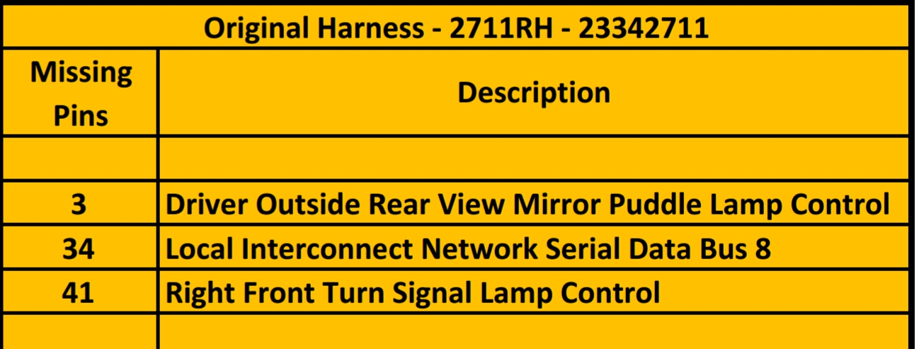

It looks like I'm missing only 2 pins from the body harness (3,34 passenger side) do I need them? I've notice that pgamboa you're missing 34 also, Thanks for the info I really appreciate that
This topic and post has come a long way since the initial research. Let me know what you are trying to accomplish and will try to guide you in the right direction. I see your truck is a 2500HD based on your sig. Pin #34 is a Serial Data Bus #8 which is not needed for the DL3 Mirror upgrade.
