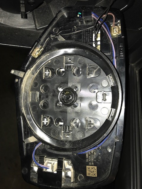

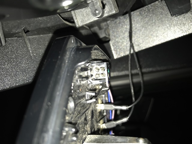

HI very good info. I have a question, I purchase the Syppo mirrors and the mirrors has 4 loose wires Outside the connector ( 1-blue. 1-white 1-orange 1- black/white. Do these wires need to be pin into the connector. If so can you please instruct me to where by wire color and connection number. Thanks

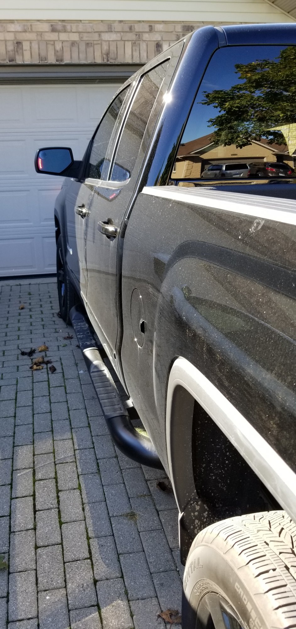

Big kudos to pgamboa! Picked up some DL3 mirrors up this weekend from Kijiji (craigslist) for $200 and modified them with his DL3 DIY kit. Rained like hell here this weekend but following his YouTube videos everything disassembled apart nicely with no surprises. My 17' Sierra Elevation SLE is one of a kind around here with power folding, puddle and t signal mirrors :D
