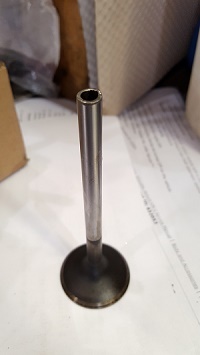

Normal driving, truck has 2800 miles on it.
number 7 cylinder
here is the report from the dealer that worked on it.
VERIFY SES LIGHT ON.WOULD BARELY RUN TO BRING INTO SHOP.DIED
- ONCE IN SHOP.WOULD CRANK OVER & TRY TO FIRE BUT NOT RUN.SCAN
- TEST P0300 P0106 HISTORY.CHECK MISSFIRE DATA,SHOWS #7 & 8
- CYL SLIGHT MISSFIRE.ST TO CONTINUE DIAG

- REMOVED LHS VALVE COVER & FOUND #7 EXHAUST VALVE BROKEN.
- BORESCOPED CYLINDER,COULD NOT SEE ANY MAJOR DAMAGE.
- REMOVED LHS CYL HEAD.VALVE IS STILL IN HEAD.BROKEN END OF
- VALVE MUSHROOMED OVER SO IT WILL NOT COME OUT.NO DAMAGE SEEN
- ON PISTON.
- FILE END OF VALVE STEM TO REMOVE.
- COULD NOT SEE ANY DAMAGE TO GUIDE.P&A PARTS
- REPLACED #7 CYLINDER EXHAUST VALVE,SEAL,SPRING &
- RETAINERS.REINSTALL
