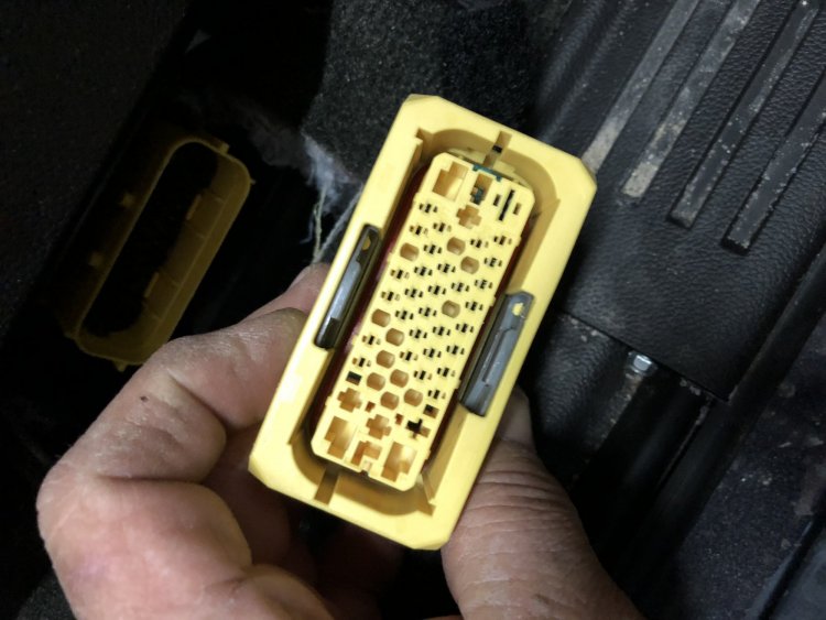

This is the plug I have

That’s the plug for the passenger seat itself.
I need to see the plug that is under the seat (towards the jumpseat). There should be a square cutout in the carpet. Take a peak and snap a couple of pics.

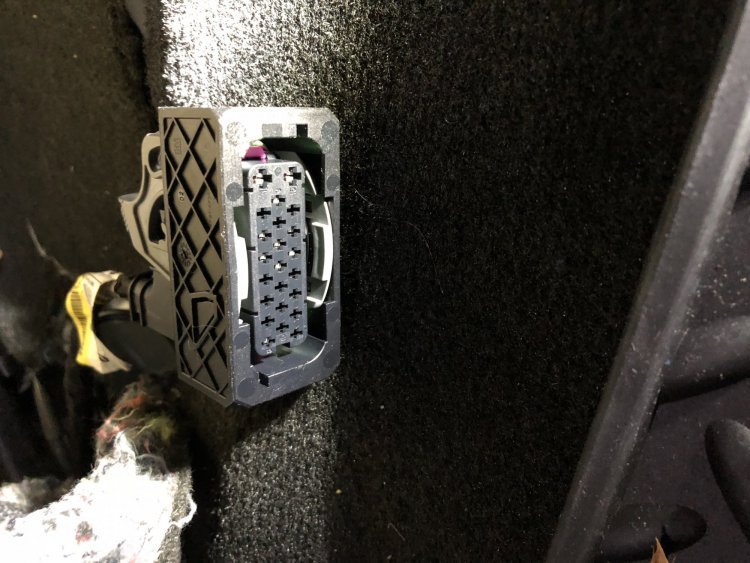

Is this the one??
Yup. That’s the 23-Pin connector. In order for me to build you a harness, you’ll have to pull the jump seat out, fully extract the harness, and send it to me. I would them build off of that.

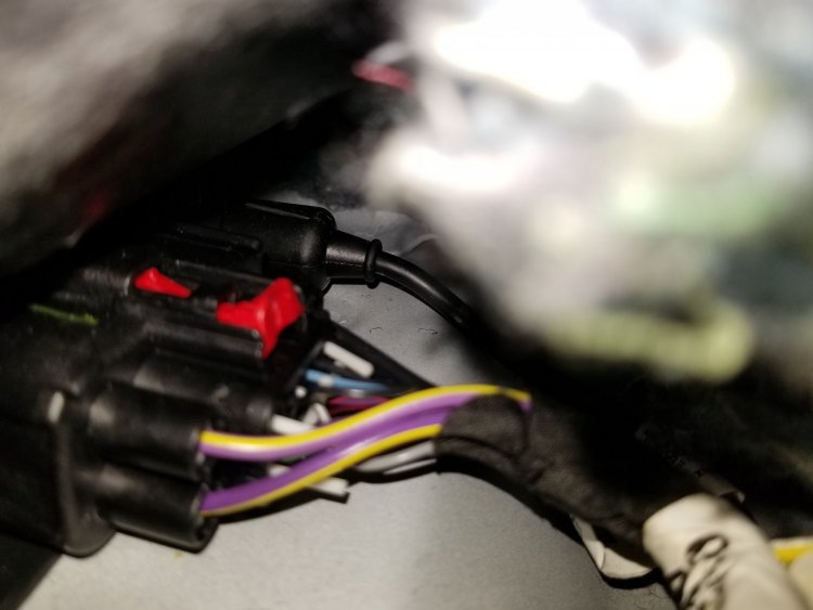

Can you tell by this pic if I have the 16 pin connector.  I knmow it's a bad pic didn't have time to move the seat to get a better pic. My truck is a 17 LT Z71

16-pin

Ok thanks I will be getting in touch with you soon for a harness.  Thanks for the fast reply!
