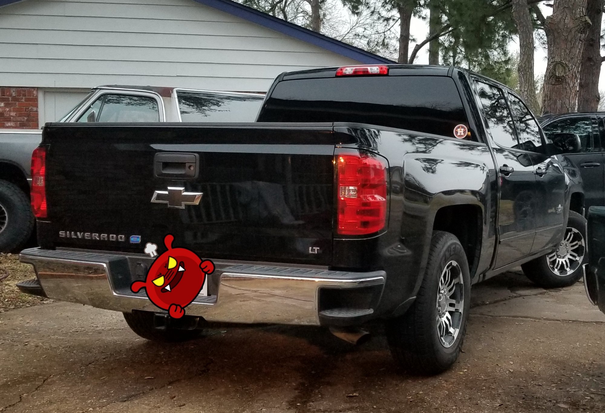

I have a black Silverado and I have all of my emblems blacked out with plasti dip. I recently covered my bow ties in vinyl. I have not had any issues with the plasti dip other than the few spots that I got it a little to thin. I know plastidip makes a spray on remover that makes it easy to come off if you need to start over. I like this concept cause I can change it easily if I want to go back to the chrome badges instead of having to buy another badge or something. Hope this helps.

Vinyl is the center Realtree part and the outer chrome is plastidipped flat black. I had my entire grille plastidipped but found a good deal on a black grille so I changed it out so I wouldn’t have to worry about rock chips or anything. All the lettering on the truck is plastidipped for over a year and no issues.

Plastidip also has a glossifier that will make it glossy. I just like the flat black look. I kept the badges on the truck and masked off with regular blue painters tape about two inches from the emblems and sprayed it. It will peel off the paint without issue and stay on the lettering. I was actually thinking of doing Realtree vinyl on the lettering but that is too much of a pain in the ass for me. :)
