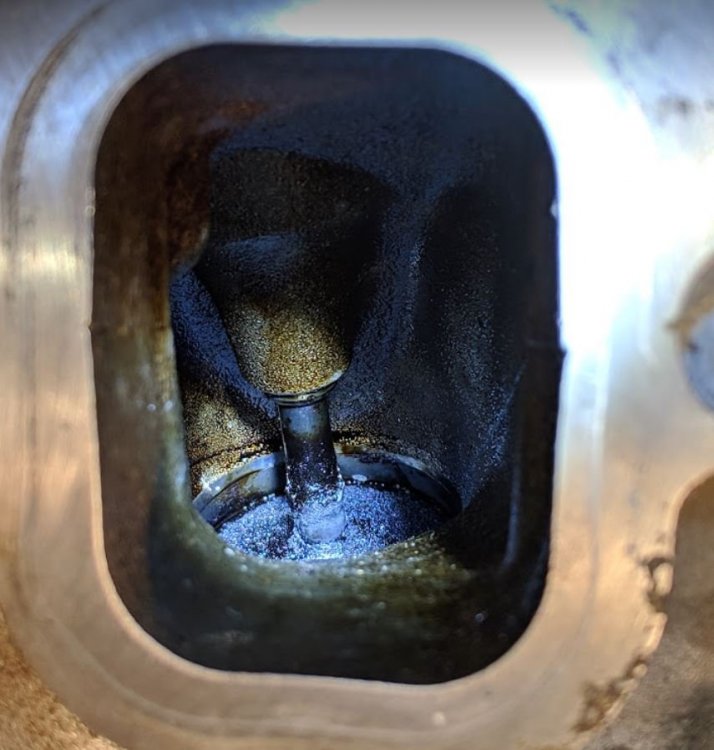

All went well this weekend. Took a little longer than I wanted, but that's to be expected with any first time job like this (for me anyway). Learned a few things and know how to tackle this much faster next time, hoping there isn't a next time though. Injector 3 and the intake valve for 3 were NASTY (pics below). All other injectors and intake valves had build up, but nothing compared to 3.
Crazy as it sounds, I had 2 issues happening at the same time (hence why I got P0303 and P0106 codes). Fuel injector 3 was failing on me and same for my purge valve solenoid. I got all the injectors and fuel lines swapped out on Saturday and the truck started and drove beautifully that night and on Sunday. Come Monday, I started it to go to work and holy sh*t, it had a rough cold start. Threw the P0106 code again so I figured my next step was the purge valve solenoid since I had replaced both the MAF/MAP sensors and couldn't find a leak in any hoses/lines. Swapped out the purge valve solenoid and now I haven't had a rough start since.
I'll write a How-To when I get a chance. Hopefully in the next week or so.
So here's the injector on 3, and the intake valve on 3 compared to 1. There was definite blow back as well as MAJOR build up partially blocking 3 from pulsing properly. I'm guessing the build up would harden enough over night or after sitting all day that it would cause misfires in 3 on start up, but soften as it warmed up and then be good. I'm also guessing seals were going bad. Anyway, all intakes looked like 1, except the dark cavernous hell that awaited me in 3. Keep in mind my truck had 77k miles on it when I took the pics of the intakes.
INJECTOR 3
INTAKE VALVE 3
INTAKE VALVE 1

No catch can. The intake valve 1 picture is the best representation of my 77k mile engine build up (3 is not accurate due to the injector failure). I did the BG air fuel induction cleaning service right before I pulled the intake off, but I have no idea what they looked like before the BG service. I can tell you that I do not use oil though. I do my own changes and there's always a hair under 8 quarts that drains out (obviously some oil will still be on parts in the crankcase and some sticks to the oil pan I drain into), so I'm not getting any blow by. Not arguing against a catch can, but if I'm not using oil I'm not sure why I would invest in one. I get why others would do it for preventative measures or if they're using oil though.

No I didn't touch them while the intake was off. If you get any of that gunk or hard carbon build up in your cylinders you can really mess up your engine. My opinion, it's best left to a professional that's covered by warranty if they screw it up. A professional will either media blast each valve (Walnuts believe it or not), perform a BG air fuel induction cleaning, or pull the intake and clean them with brushes. There are plenty of videos in YouTube of guys cleaning their intake valves. You need to make sure they are completely closed by turning the cam, doing it one valve at a time. Even then debris that you knock off from cleaning it can fall in once you turn the cam or start your car.
Something you can do yourself that doesn't hurt anything is buy a can of CRC GDI Intake Valve cleaner (has a long plastic hose on it). Follow the instructions and it can help clean some of the build up.
