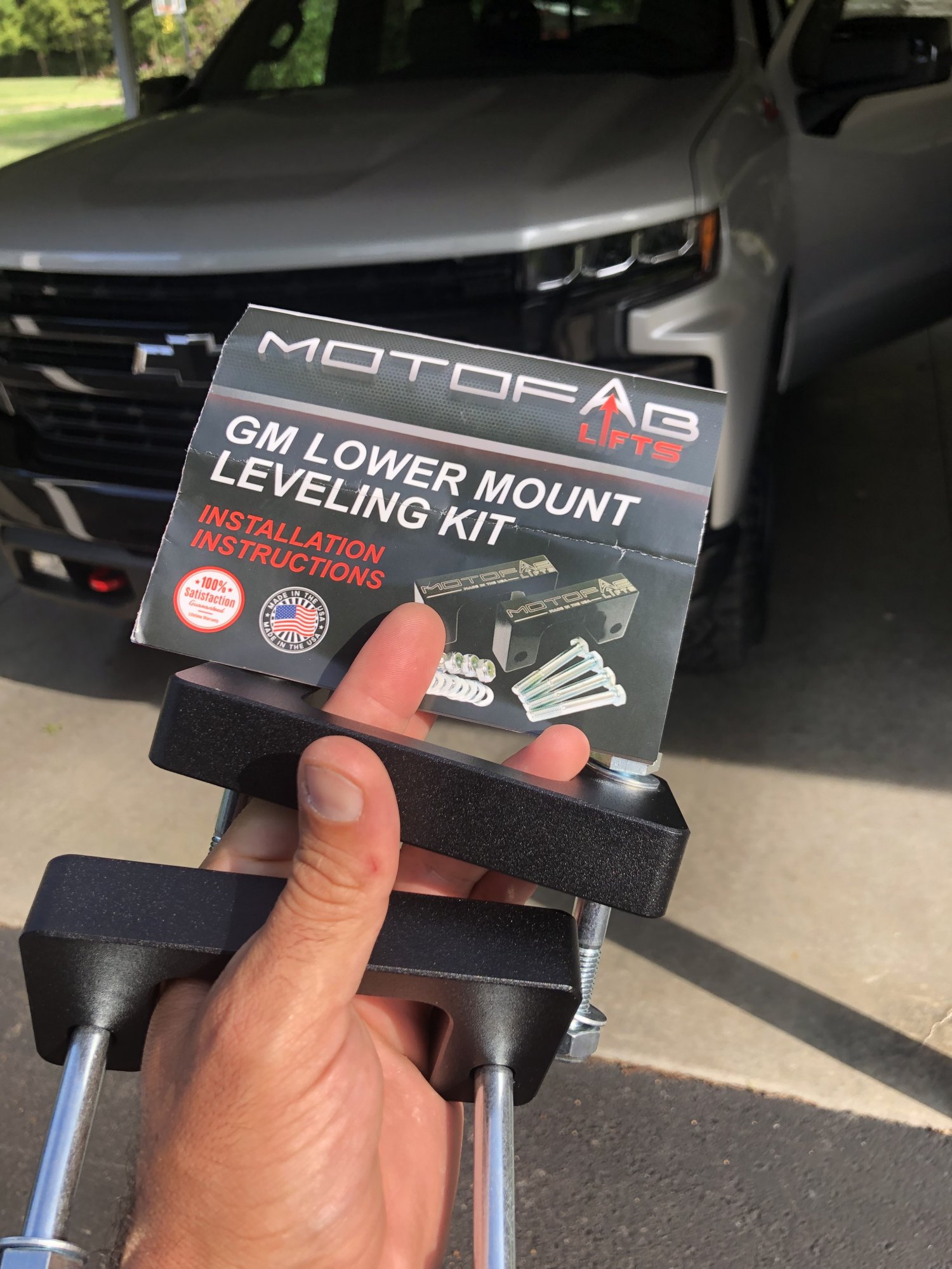

FWIW, I measured my trail boss before and after my 1.5” motofab. By my measurements it was exactly 2” lower in the front. Put on the 1.5 and low and behold, it raised it 1.5”. Haha.
Kinda wish I would have went with the 2”, because there is still a hair of rake. So to those who haven’t yet, always measure first!

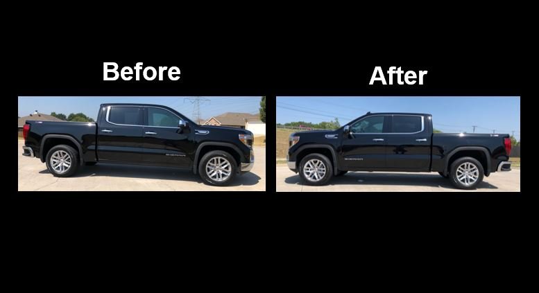

Edited: Decided to go with a Motofab 1.5" lower spacer.  I still want a little rake for hauling.
I had right at 2.25" of rake. Here is the result: just a little over 1.5" of measured increase, call it 1 5/8". This will still give me a little under 3/4" of rake.  I am really happy with how it came out.  Took it to be aligned and it was still within the acceptable range on every measurement. These pictures don't do the difference justice, it looks much better with a slightly more level stance. Great deal all the way around!
