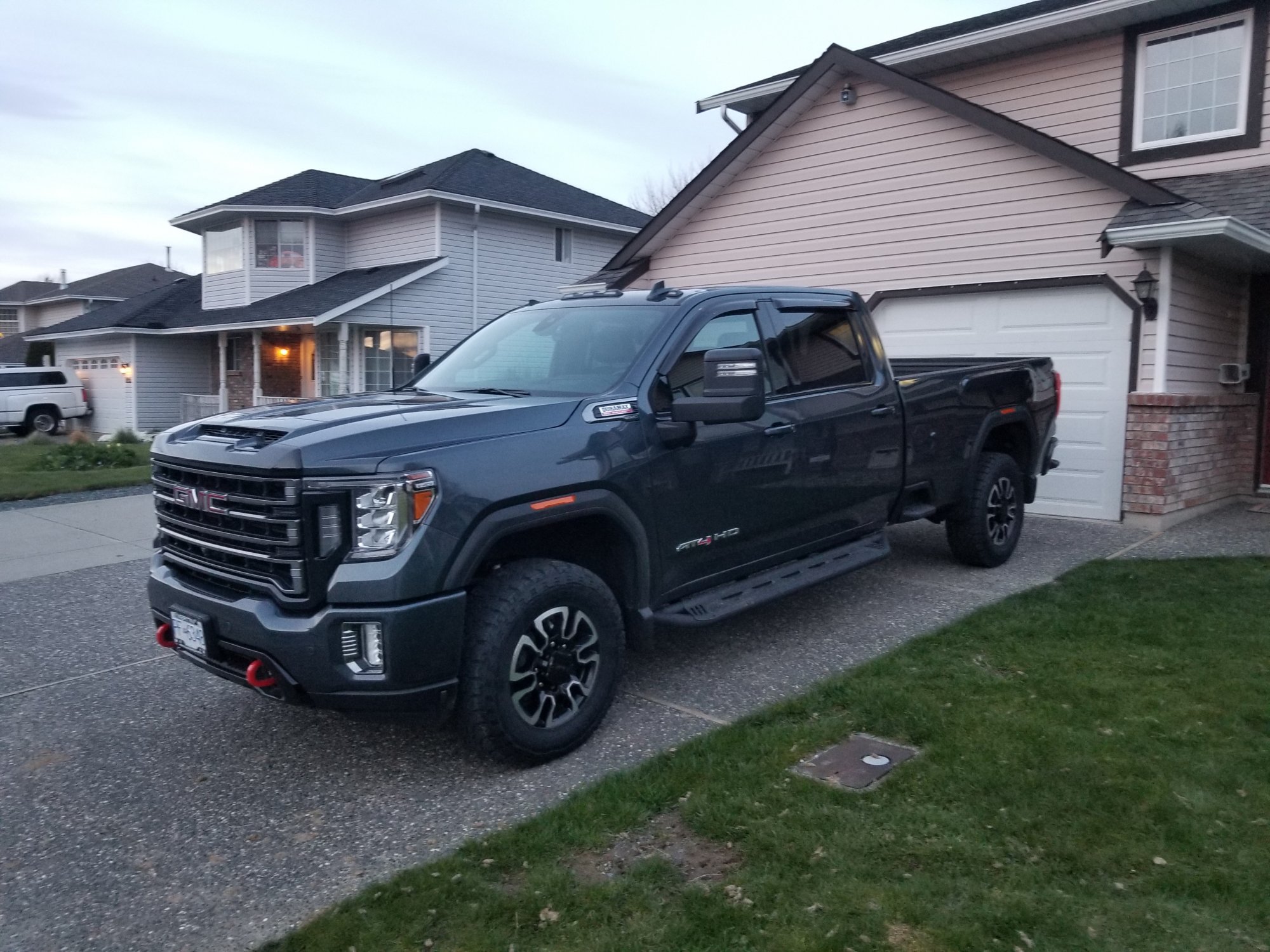

My Truck finally arrived!  Picked it up yesterday.
Congrats Dan! It’s a good day

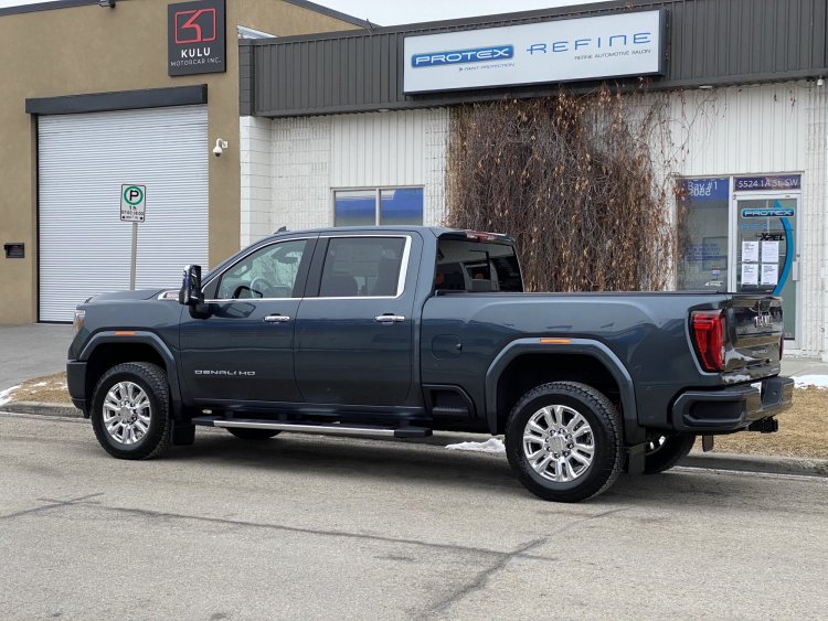

Finally picked up my truck from the detailers today. Finished up with a full PPF and ceramic coating. I also threw on the Gatorback mud flaps before I drove it home.
Big shout out to Richard at Refine Automotive Salon here in Calgary - absolutely amazing job. Very happy with the results.

Looks awesome!  Glad you finally get to take her home!  Let me know how it is for repelling the water spots and dust.  Mine looks dirty right away.  I have mine booked in for PPF on the front, but still debating the ceramic coat.

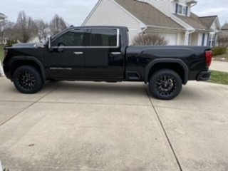

I have 285/65R20 BFG KO2 tires with Moto Metal 20x9 +18 wheels on my stock 2020 GMC Sierra HD with no problems.

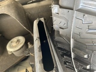

4 - Fuel Offroad Vandal D627 Black 20x9 8x180 +20 (PN: D62720901857)
4 - Toyo Open Country A/T II LT295/65R20 (PN: 352870)
Stock height, no trimming, no rubbing. less than 1/2" clearance at full lock
