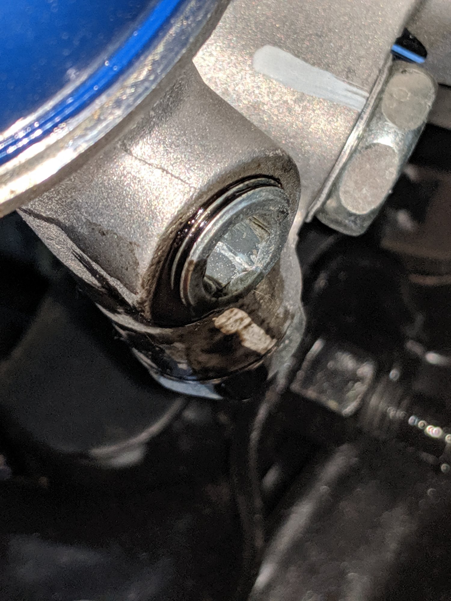

Here is a sample of the leaks that I've been having on this truck. So right now it looks like they might have fixed the rear engine leak. That's it as far as I can see. I will update again when the weather clears up and I can get back under the truck.

Wow..You’ve been more than patient.  You need to find a new dealer that has competent techs...Pliers on the coolant cap, hands too big so just skip things, multiple trips filling coolant and sending you on your way even though it’s not leaking, not to mention multiple trips for oil leaks...Terrible service department to say the least.

Well here is my story for what it's worth. Dropped off truck a week ago after making an appointment. 4 days later they called to say they hadn't got to it yet.???WTF Dealer only has one rack that our truck fits on. Got a call from GM the following Monday telling me truck would be done that day and he would call back later in the week. Dealer called later that day saying truck would NOT be ready due to the oil filter housing adapter that had to be replaced they needed to pull the water pump to replace the adapter. Got called on wednesday from GM asking how the truck was told him dealer just called to pick it up, but no paperwork would be provided due to the nightmare of the Bright wheel recall. Wife went to pick up truck and the low coolant light was on. So back into the dealership for a 1/2 hour to purge/vacuum out the system and filled the coolant and away she went. Started truck on Thursday low coolant light on yet again so back to the dealer for a top off of coolant. Started truck today low coolant light on again. Back we go to the dealer for them to perform another vacuum of the system and top it off. Picked up all the paperwork and surprise a check for $795 for the Bright wheel recall. Progress at last. Still no idea if any of the oil leaks have actually been fixed or just changing out more parts. Will climb back under it this weekend to take a look see. Confidence is low.

Oil filter adapter housing
