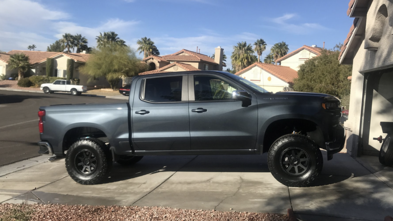

Help a brother out, level kit.
Just now, lapoolboy said:
Trailboss lift top...
Stock bottom left...
ReadyLift 4" SST bottom right...

Yes, the top pic is how it currently sits with the 2" factory Trail Boss lift kit.....2" in front, 2" in rear

35x11.5x20
that's without adding the 1.5" you were talking about?

Guys, the level kit I have going on Thursday is just a small preload spacer to get the 1.5".  This is done within the length of the strut and no length is added to the strut assembly.  Yes, the control arms will sit at a more downward angle to get the 1.5" I need to level, but the range of motion of the control arms is still within the physical limits of the suspension as designed by GM.  Now, the horseshoe style spacers that go under the lower strut mount DO increase the overall length of the strut and have the potential to push the suspension outside of its intended range.
Simply modifying preload is not going to suddenly cause balljoints or CVs to fail.....it is all designed to work within the full range of motion the suspension could experience from full compression to full droop.  All it will do is "firm" up the feel of the front since the spring rate is now modified.  Make sense?
