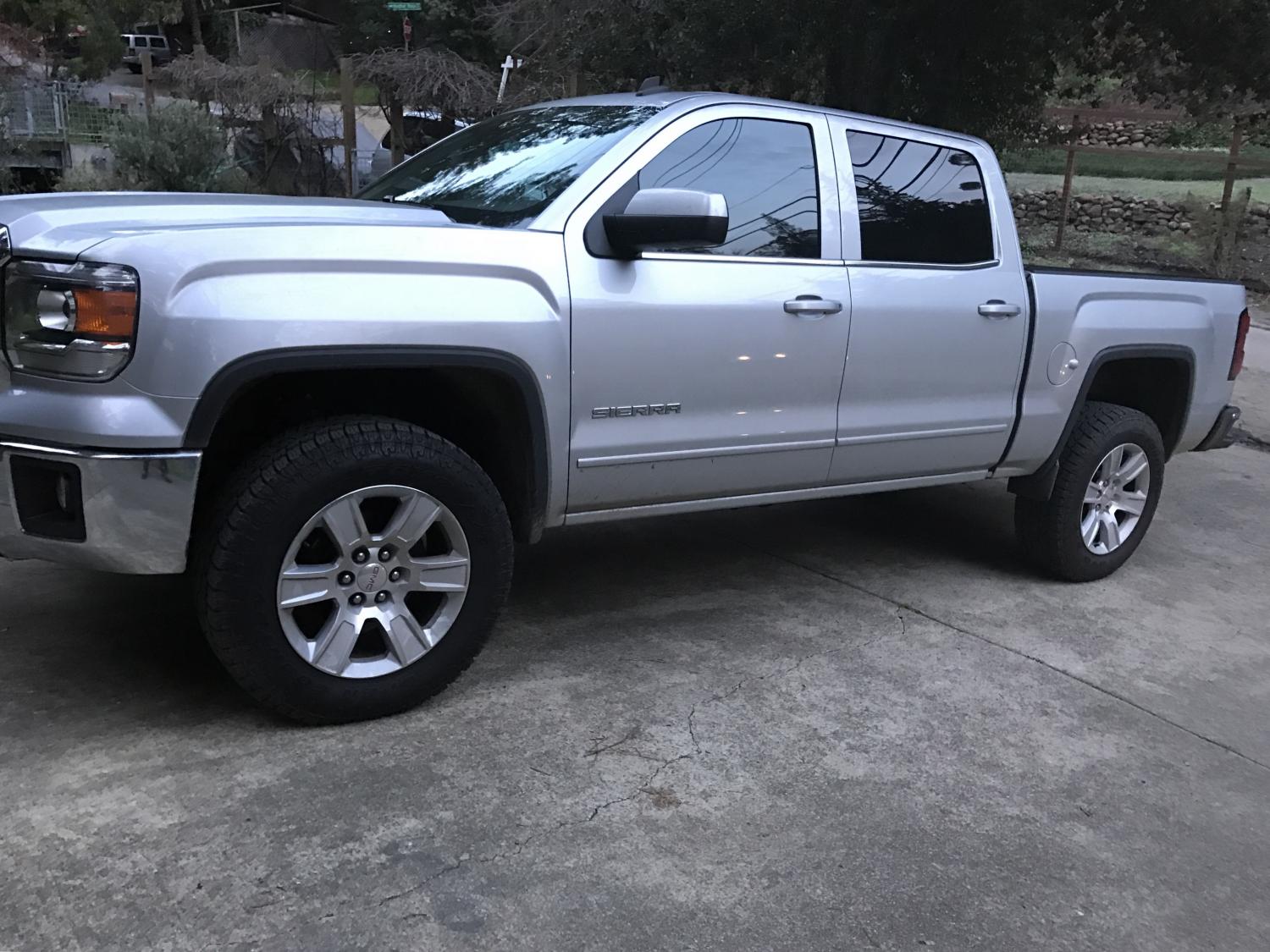

2in rc level 275/60 no rubbage rides like stock on bfg rugged terrains d952fa73b79145273727ef672f3e13c1.jpg
Sent from my SM-G935F using Tapatalk

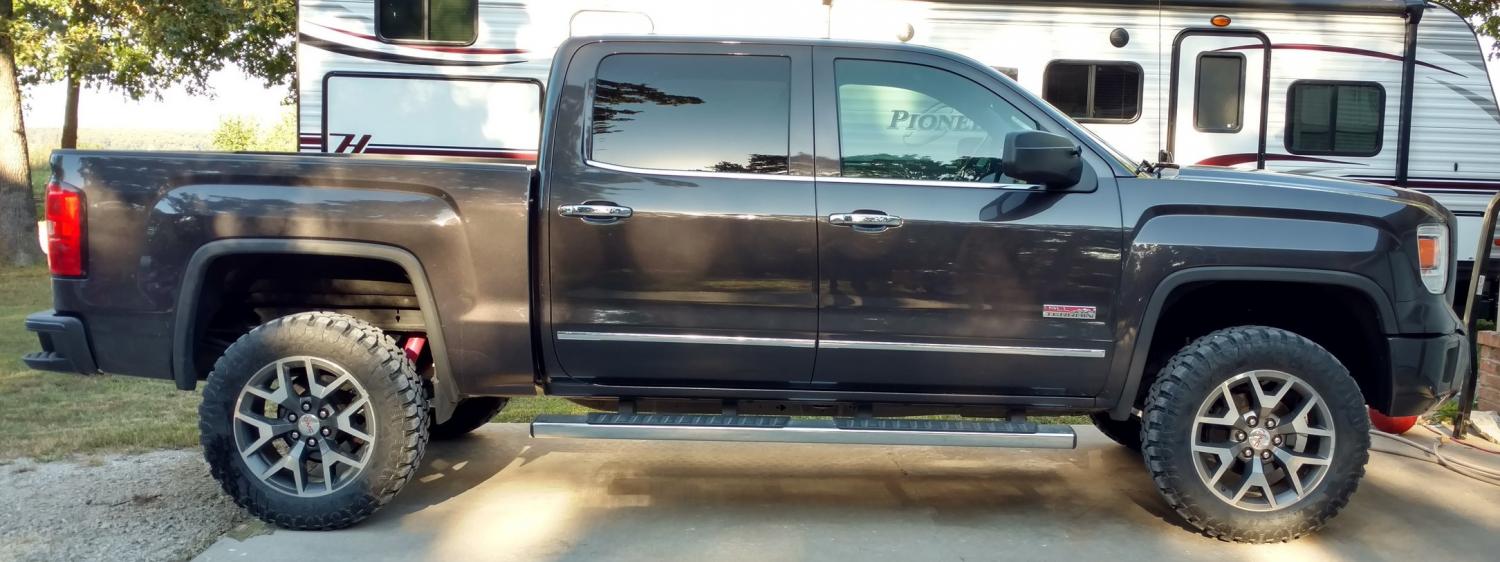

Gonna change out the Ranchos for some Bilstien 5100 and get the front another .5 to 1" higher. Also unlike I've read in several posts I had to space out front wheels also to get the right "offset" look. Here's now. I'll post up another after the Bilstiens get installed.

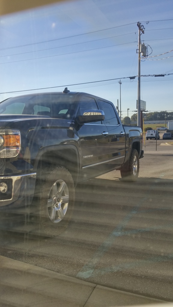

2014 Sierra - 2WD
2.5 inch front level
2 inch rear block
275/65/20 Toyo Open Country A/T II
No rub at all. No trimming required.
