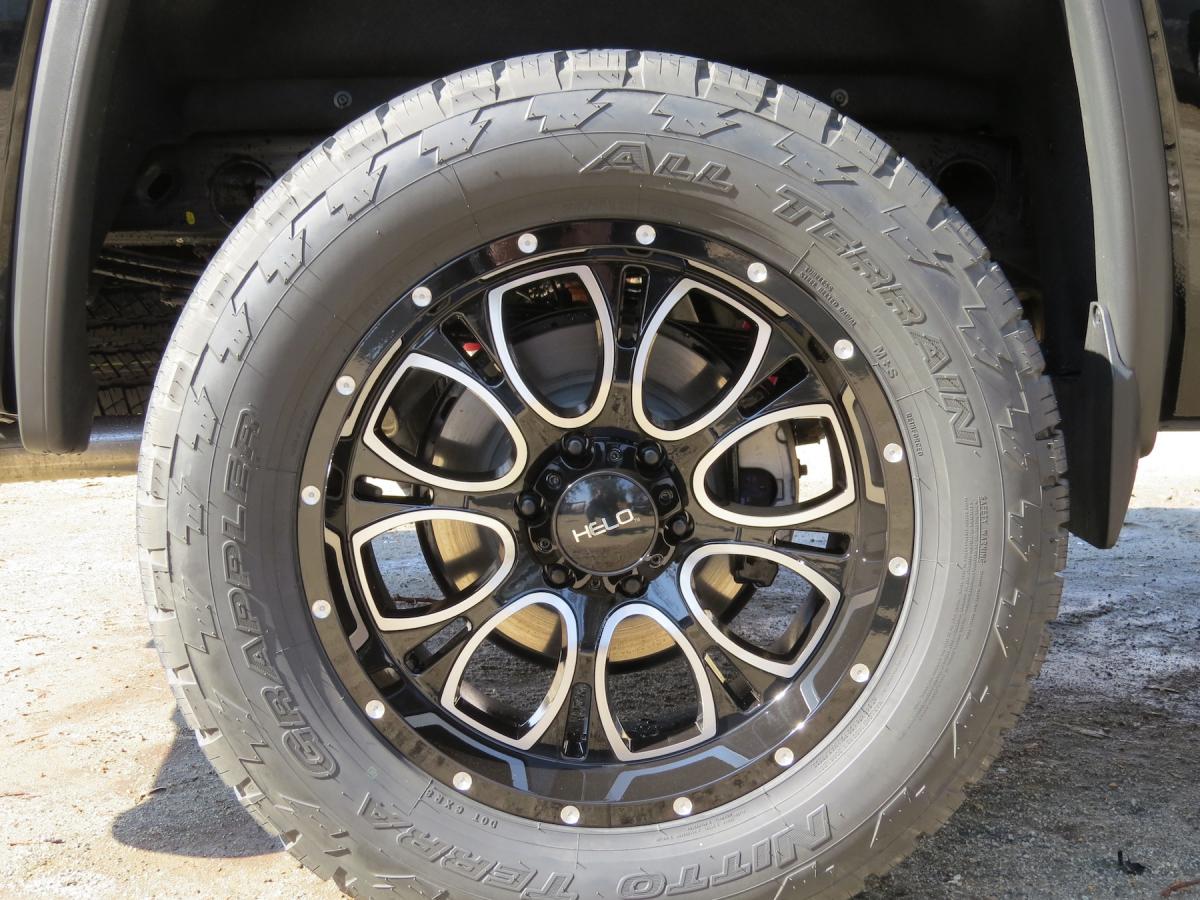

I went with these tires and wheels and they are surprisingly quiet and don't rub but the offset of the wheels and the lift makes it work. 305/55R20
