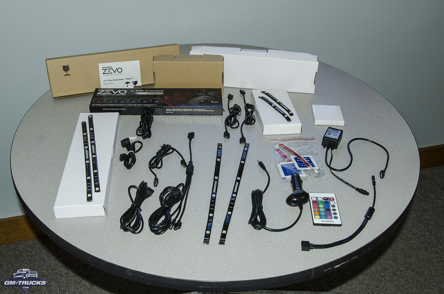

The starter ZEVO kit includes two 12-inch led strips, a controller unit, a remote and enough wire to light our front foot wells. The kit can be easily expanded on with a 6-inch and 12-inch add-on sets. We used the 6-inch expansion kit to light the rear foot wells and the extra 12-inch expansion to light the under seat storage. Sylvania includes more than enough wire and splitters for most installations.

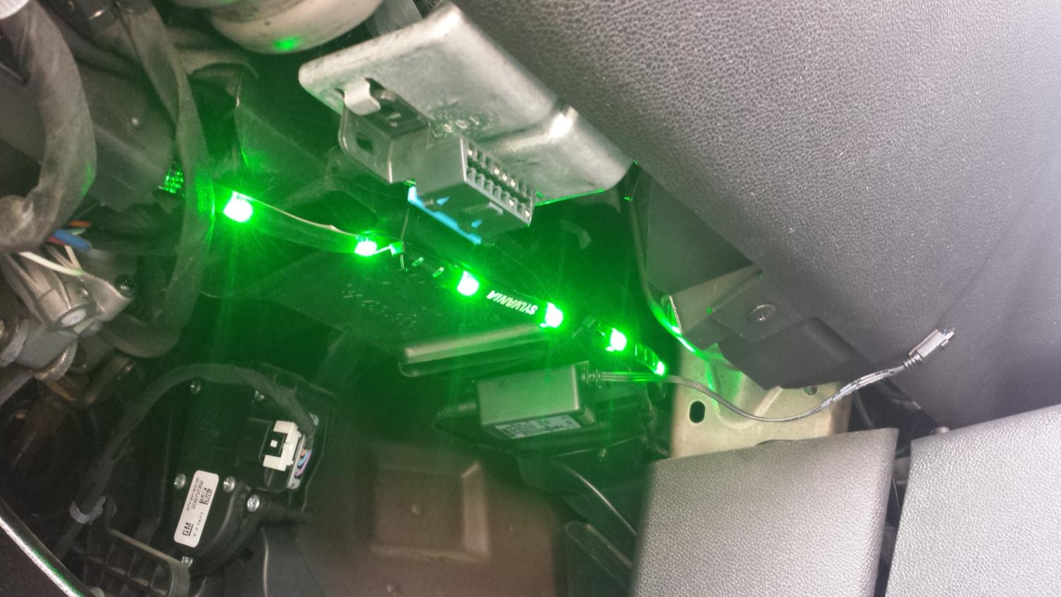

The first goal is to mount main control unit. It needs to be in a location where the infrared sensor can point up towards the cabin. Next, we plugged in the splitter and ran the power behind the lower console to the passenger foot well. Once the wires were run to their general locations we test fit the LED strips and plugged the car adapter in to make sure everything worked before we mounted lights and hid wires.

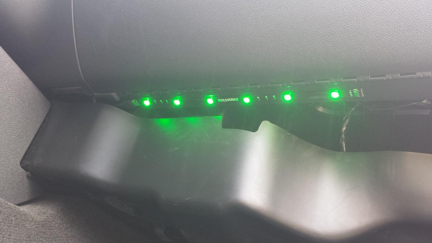

It's important to carefully consider where to mount these LED light strips as they can be very bright. Make sure to locate them in a spot where you won't directly see them while driving. We placed our strips facing down towards the floor. To mount, we just peeled off the adhesive and stuck the light strip to a flat surface while firmly pushing them down. That's it! You're done.

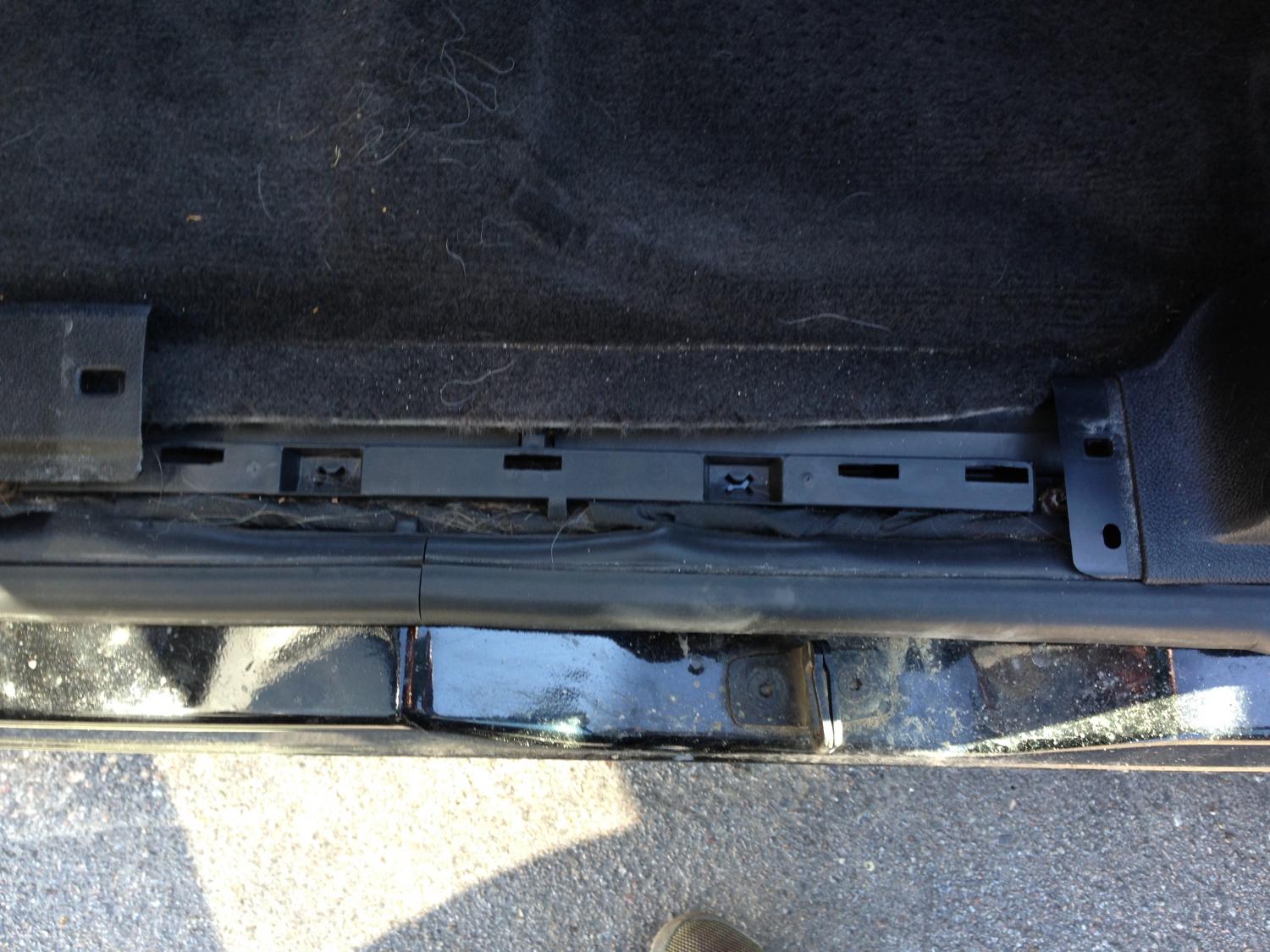

Adding the additional expansion kits to the mix was slightly more interesting because we needed to run the wires to underneath the front and rear seats. We took off the door kick panels so we could pull up and run wires under the carpet.

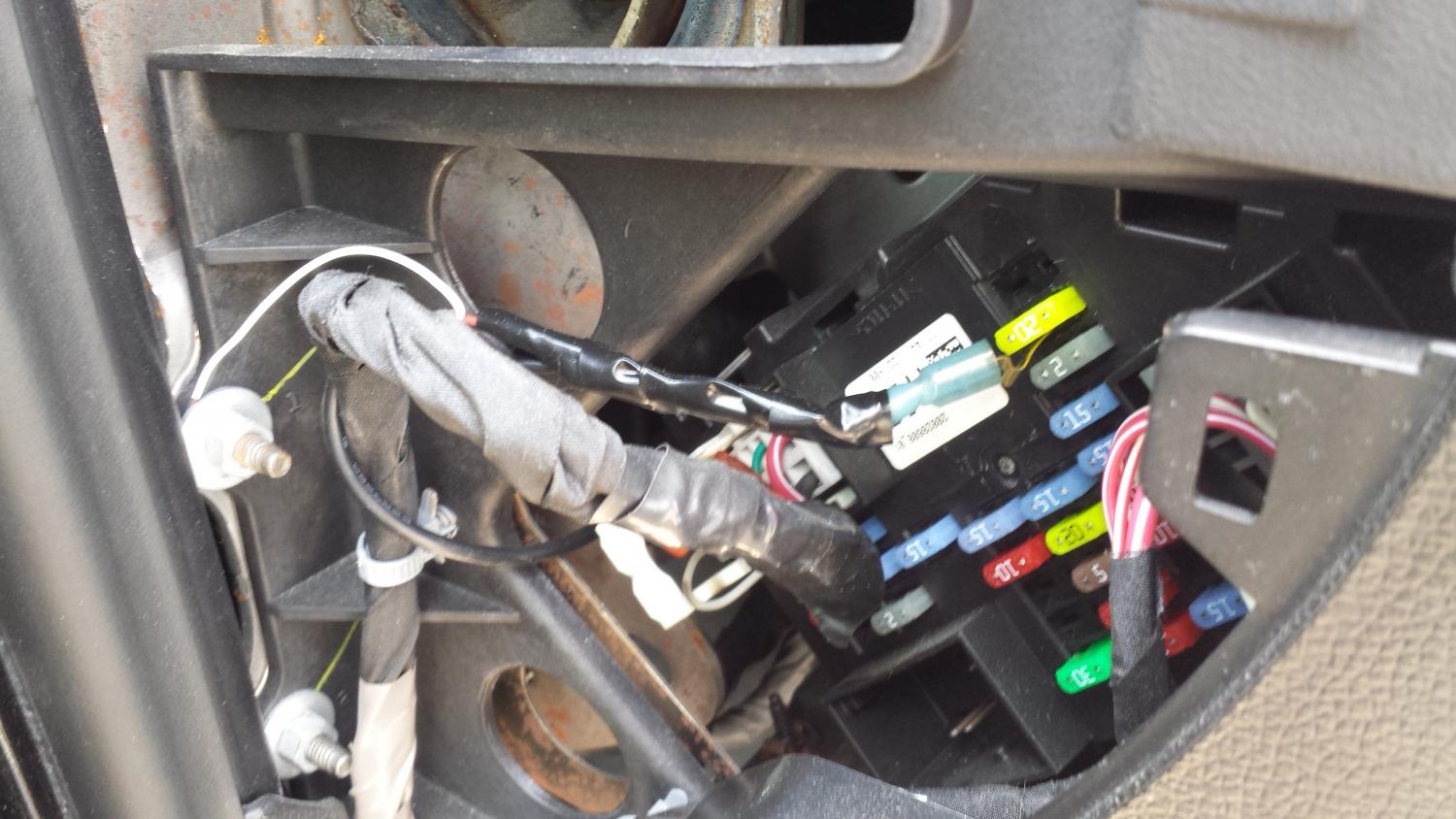

Optionally, you can simply cut off the power adapter and hard-wire your ambient lighting kit into your vehicle for a cleaner look.
Once you've stripped the power wire, use a jumper to tie the wire into the accessory fuse. We used a simple wire stripper and cut as close to the 12-volt plug as possible. We than ran the power wire to the internal fuse block located in the driver's side door jam. We use a simple fuse jumper and tapped into our accessory power. Since this is always on battery power, these lights will work no matter if the engine is on or not. That can be both a good and a bad thing. In the future we'll search for a keyed power source to prevent accidental battery rundown.
