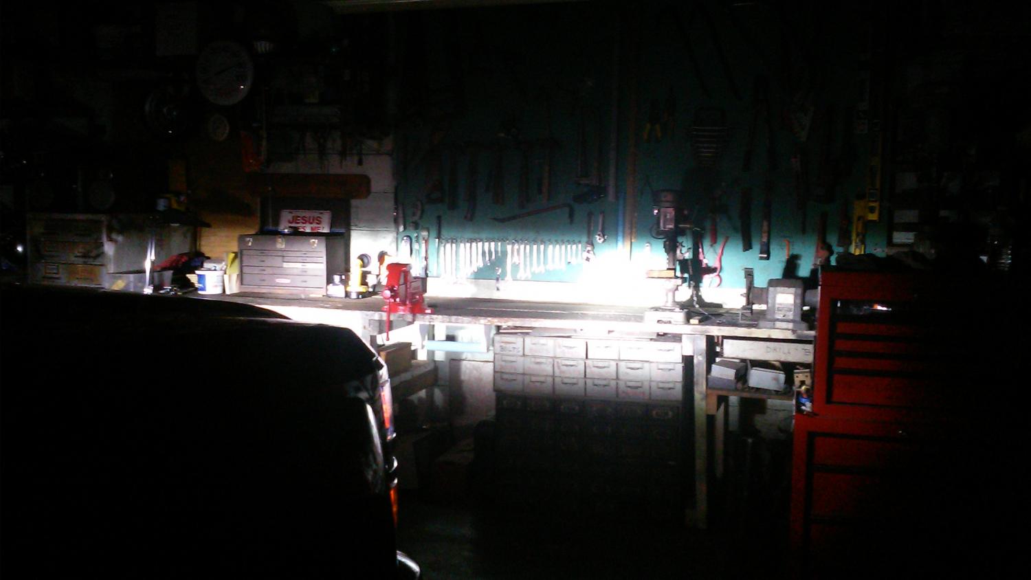

Finally installed the Opt7 6k LEDs. Just wanted to say thanks to you guys providing some valuable info for choice of LEDs and installation. These things are BRIGHT... I wish the H11 were in 5k for just a little less blue tinge in the light, but overall I am pleased.
  • Replies 271
Looking good!
Glad we could help! I love my lights but I agree a 5k would have looked a little cleaner. All in all they are awesome though!

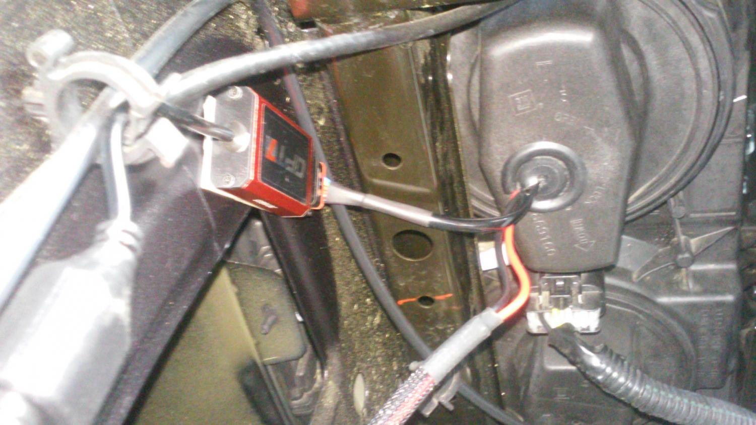

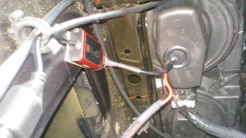

I'm not sure how you guys oriented all of the wiring and the controllers. I read previously that someone stuffed all of it behind the dust cap and sealed it in. I was a little concerned about heat exposure to the controller and the wiring, so I do a little DIY. I drilled a hole in the dust cap and ran the controller/wiring through the dust cap, and used double sided tape to stick the controller to the sidewall of the engine bay. There were already wires running through some tracks along the side wall, so I ran the excess through the pre-existing tracks for neatness, then ran it back into the dust cap which connected to the factory harness. To eliminate the giant hole in the dust cap, I sealed it back with a rubber grommet. I cut a slit to the center of the grommet to allow the wires to run through. Here is pic of the drivers side low beam dust cap
