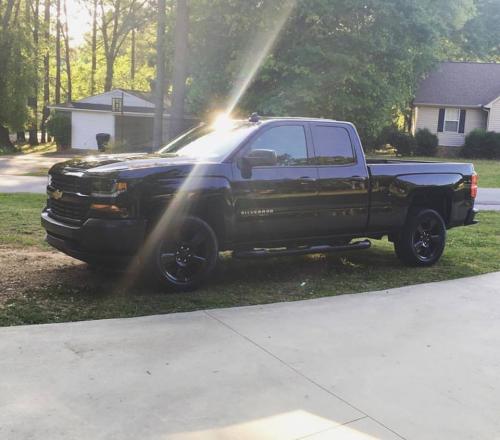

So, I'm looking to install a remote start system in my truck. I know some trucks already come with it wired up just does not come with the keys. My truck is a 2016 Silverado WT, which does not have it installed. I need some input on which one you guys think is the best for the money.
Thanks for the help in advance!
