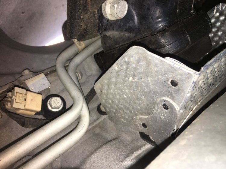

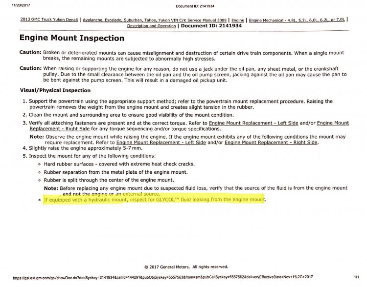

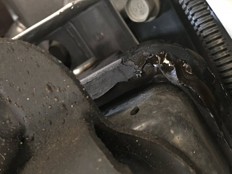

I need help figuring this one out, I just bought this Yukon XL (100k) and drove it home (about two hours of driving) and I had a fluid puddle on my driveway the next day. So I checked it out and the only spot where I could find any “leakage” was from the drivers side motor mount. There were no other apparent fluid leaks or spills from anywhere else. I took it in to have it looked and and the liquid had dried and only left minor stains. He thought I was crazy at this point. I asked the tech if he could check the parts listing to see if it was fluid filled. He came back with a engine mount checklist which states to check for fluid leaks from the mount if equipped with GLYCOL(i.e. coolant) but also said he doesn’t see any signs of a leak even after I showed him pictures and he pulled up the inspection checklist. I need proof that the mount needs replaced because the fluid has leaked out. GLYCOL dries to show very little sign of leakage. How much fluid could he expect the mount to hold to keep leaking? How can I know for sure that this mount is the fluid filled kind or not? I took pictures of all of this. E2A03872-3823-4126-BE53-370B8E6FCBA3.thumb.jpeg.e2d280db6c83086bdfce156ee69c70fe.jpeg8BA5F5A7-915A-4956-B46B-9D96A882C539.thumb.jpeg.a524b6505cb0208bb0af2bc7eaa97c8c.jpegB1CACDFB-8639-4232-9FA6-5D477C9FAEF7.thumb.jpeg.52d32f53b3acac2a59d46bbaa37bfdc4.jpeg

I would replace the mount - done deal.
Try tasting the liquid, if it has an immediate sweet taste it is glycol.  No need to swallow, just touching the tongue is enough.

Ask the service manager to talk to parts manager if they are using hydraulic mounts. If you bought the truck there, talk to owner of dealership, and include salesman in discussion. Or, if the mount is still wet, ask them to repair the coolant leak. The mechanic in the shop should know if it has hydraulic mounts. Don't assume that they will be inept, these mounts have been in use for over 10 years now, someone at the dealer has heard of them. Quick search in Google will show that.
