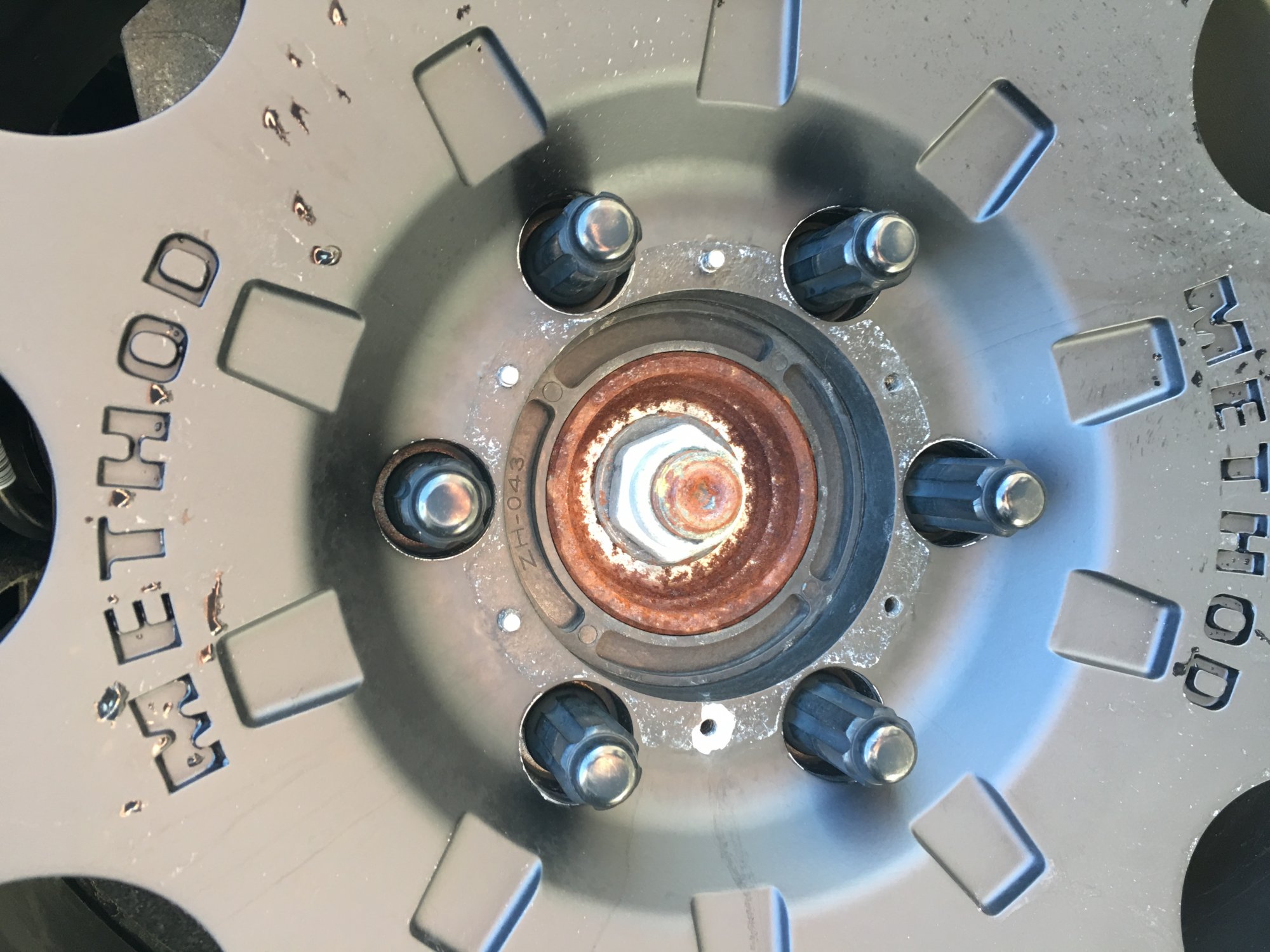

Looks great!  I have these wheels in the 18" version, with 275/65/18 Duratracs.
Please be aware that the center caps will corrode badly if left on during the winter!  I installed mine in December of last year, and by March they looked awful.  I went to remove them to replace with black painted ones, and several of the bolts were seized and the heads broke off during removal (see picture).  Also I discovered that the black paint underneath the caps had begun bubbling and flaking off.  I purchased them through tire rack, and they denied me warranty coverage due to the corrosion.
I would strongly recommend clear-coating or painting the center caps, putting some anti-seize on the bolts that hold the center caps on, and maybe looking into fabricating some sort of gasket that can be installed between the center caps and the wheel to prevent the corrosion from affecting the black wheel paint.  These things should prevent the issues I had.

Thats great to know thanks. Ya ill probably just try to figure something out. Maybe run without them in the winter.
