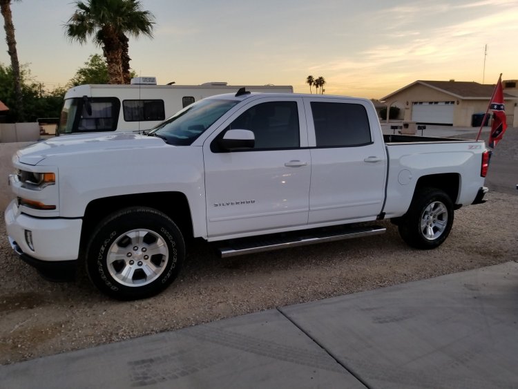

40 minutes ago, LTeddy said:
That is mine4cf6555e9234eeea8c50750c68126ed9.jpg9e2fbc97519dbce57db42d4736bf55de.jpg
Sent from my SM-N950U using Tapatalk
Nice ride, no level kit with 33 in tires on 18inch wheels?
Nope! I think if I hit a bump at full lock backing up it may touch the carpet but that's it they're also worn down just a tad from 20k of use brand new may be different but I doubt it
Looks sweet! I think that's what I'll do is either stay with 18s or go alittle smaller to fit some BFG's!
