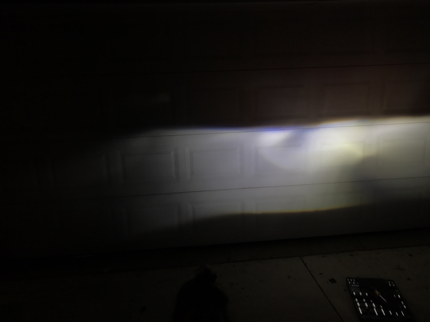

It will help alot. Here is a pic showing differences.
