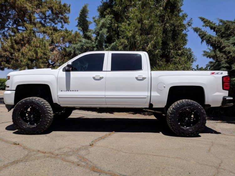

I got a question about re gearing from 3.42 to 4.11. is it necessary to get the tune/ speedometer  calibrated ?
My truck 2018 Z71 5.3 6speed 3.42 gears. I got a 8" lift with 35 /12.5/20. The actual tire measures 34.5 x 13.25.
I don't want to void the factory warranty by plugging in a tuner if possible but I would hate to cause more damage by not tuning also.
Thanks
