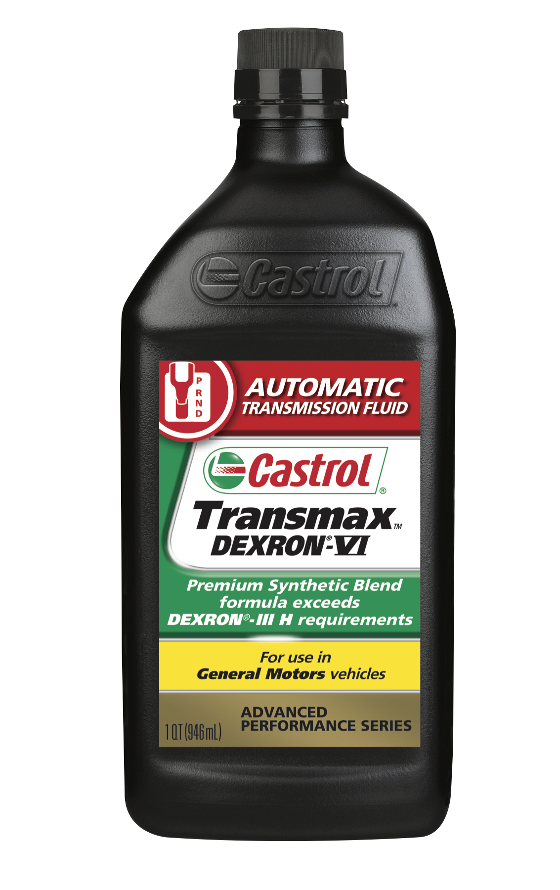

I think $250 for 3 services is a lot considering what I can do it for with off the shelf fluids.
I think I can do my 3 drive line services with off the shelf fluids for $50 in fluid cost.
75W-90 Full Synthetic Gear Oil, 1 Quart
This for differentials.
b7ca1e0a-1a3a-46d8-9e46-b48623954edd_1.5a416c697ff0802a57b3ee5ef6cc3e0b.jpeg?odnWidth=undefined&odnHeight=undefined&odnBg=ffffff
Transmission fluid I use.
