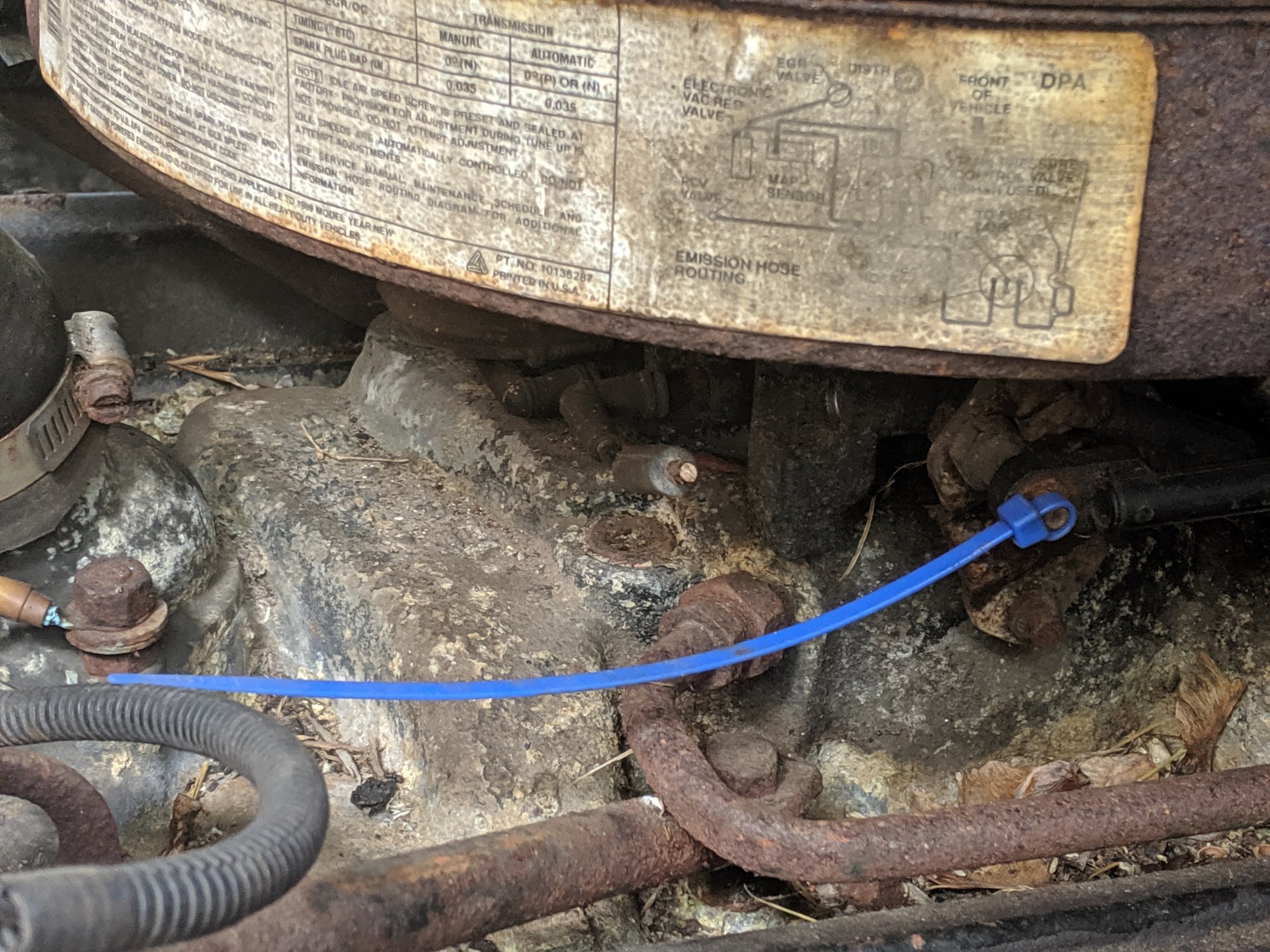

I agree with someone above, I don't think there is any way possible it's burning that much gas and "running smooth".  It would either be smoking like a freight train or running high revs, or both.
If you're asking about the nut with the wires going to it, that's the main chassis ground point.  The switch or sensor that has the two wires, orange and whatever, I don't know what that is.
That smaller black wire that goes into the plastic wire cover loom is the ground wire from the lights, I'm pretty sure.  The larger black wire I imagine comes from the battery negative.
  • Replies 37
10 hours ago, riverbanks said:
How are you determining "the burning up of fuel"the guage or just the quiting?chattering is just ticking
Gauge goes to empty then  stutter stutter stop, if you push the pedal during that time it'll briefly come back to life then stutter and die.
Althougg 5 gal isn't a lot in that tank so maybe it only runs for half an hourish and dies for another reason., There's mild ticking after it's warmed up nothing fast or crazy or loud.
I'm so used to diesels. How do gas engines deal with returning unburnt fuel? If my Gm 871 isn't returning to the tank it's burning from it does more or less this.
Alright so I put it up on ramps and there is some sort of fuel leak in the engine bay. If you were sitting in the driver's seat it would be on the left side of the block. Whats over there?
Fuel feed and return line,both hook to rear of throttle body and back to tank,third line from tank is vapor line to canister
Thanks! Is that rubber tube with the stick rammed in the end involved in any way?
6 hours ago, riverbanks said:
She is rusty,are you up to date on your tetanus shot? just kidding,pb blaster is well needed
Lol well if I knew what it was called I'd buy a whole new intake filter ufo and arm to plastic box.
For those who haven't followed the thread this is the identical truck to my childhood memories, right down to the Fischer plow. So yeah. Gonna redo whatever it takes. And get a tetanus shot.
I tightened a hose clamp no more fuel problems but she does rev up for no reason while idling then back down. No more stuttering out though
