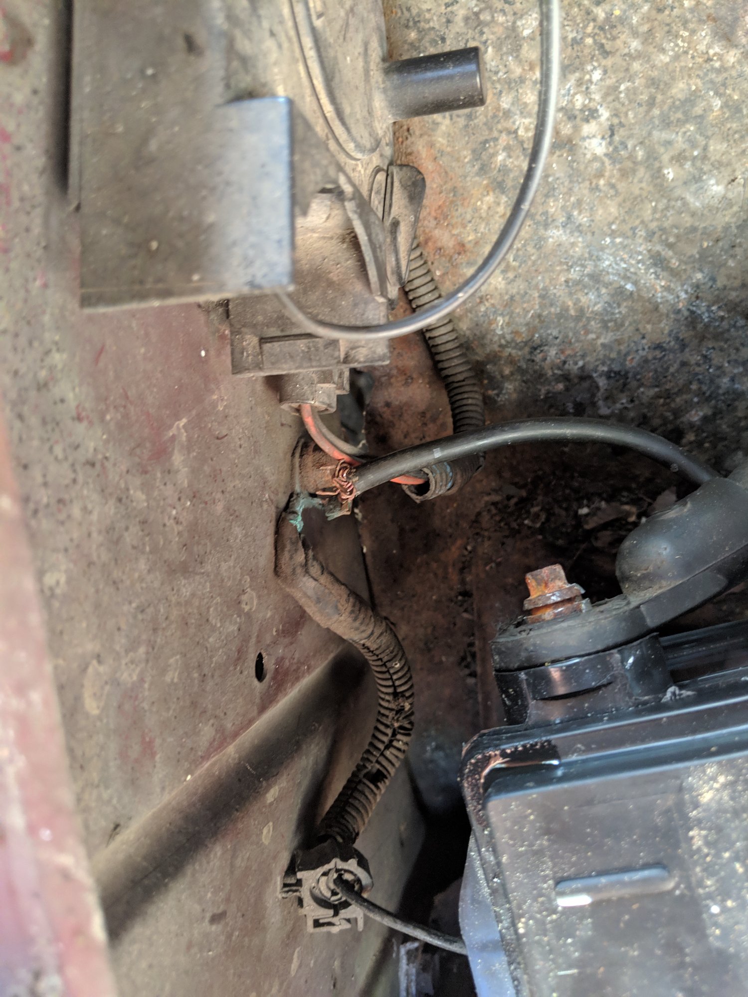

Sorry for the late replies I'm an offshore fisherman so I'm gone forever. So here's the deal, I know it needs a whole new spark system, distributor rotor, cap, wires, plug and coil along with a new frame ground.
It definitely has a fuel pump outside the tank and I agree with the above about replacing it with a real and reliable in tank pump. In fact I'll probably just replace the tank, pump and lines considering how easy it looks.
The thing that's driving me nuts right now is the fuel consumption. There's definitely no leaks, I moved it to a virgin section of my driveway, put five gallons in on top of the 3 already in there and it burned it up at an idle in about 30 minutes. It needs an air filter and there's no connecting piece from the air filter disc cover to the actual airbox on the side.
Could that, combined with a shoddy spark system create that type of fuel consumption? I'm at a loss. The only thing under the truck is a drip from the oil pan gasket, nowhere along the fuel line run is there a leak and there's nothing in the engine bay...
It runs smoothly, then the revs kick up noticeably, then back to smooth, then runs out of gas.
Fuel lines? Injectors? I've told her that back lot wasn't her grave but I'm not sure she has the will to live.
